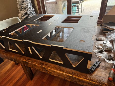

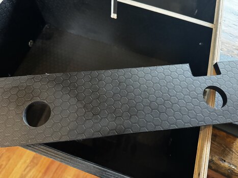

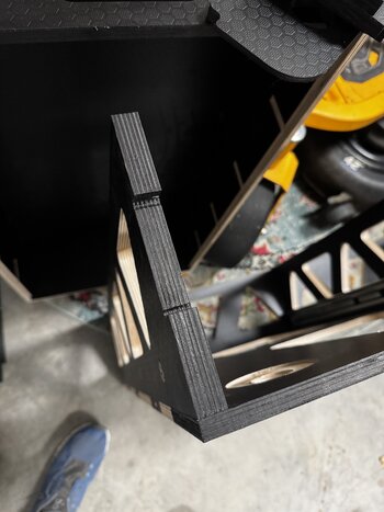

Arrived yesterday. Overall fit and finish is excellent, clean cuts and everything comes together perfectly. All holes are predrilled. Seems very sturdy and secure. I went with bed extensions and no false tops, but note the drawers are chamfered for them—would be quite easy to add my own down the road.
The locking slides are being dropshipped, so while not done, a few dry fit pictures and thoughts for the time being.
Instructional video left a few key points unexplained. Several times I had the video paused and zooming in trying to determine what goes where. Piece identification and orientation stickers would make it much easier. Written instructions would be easier to follow (maybe I’m officially old in that regard). Still only took a few hours, and that’s with doubling back to replace screws.
I used the video instructions and a few things are slightly different in application:
1. 1.5” screws for everything but the top and drawer faces. The video says build the box with 1.25” at the beginning. I was nearly done when I realized I didn’t have enough 1.25” screws—the screw packaging does specify what screws go where, I just went too fast based on the video instructions.
2. Both left and right Non locking slides on the center support use the same t-nut to secure, one side uses a shorter screw. I tightened the first side which sucked the t nut in, and the opposite side screw wasn’t long enough to capture thread. I’d recommend finger tight on both inner slides and then tighten down, not one then the other like in the video .

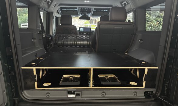

Possibly, I also likely understated total depth since I haven’t installed it yet and just added extension+top depth-it’s likely a bit longer once installed on the hinge. On their videos, the extensions go fully to the folded up rear seat back:

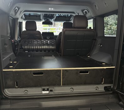

I painted the exposed edges. Acrylic paint and a trimmed down foam brush. Looks so much better for $3 and an hour or so.
