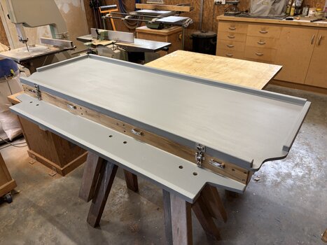

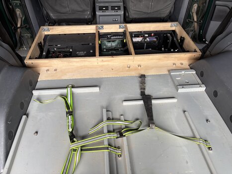

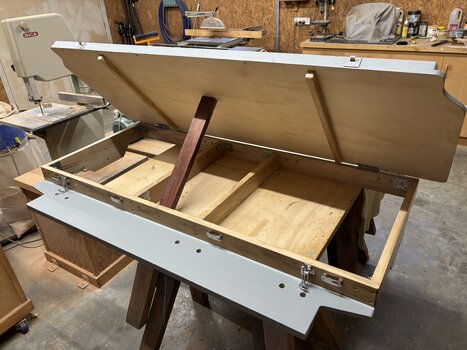

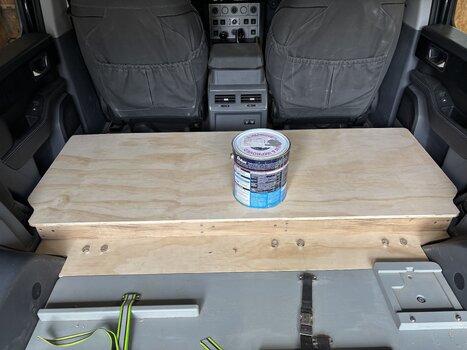

Thinking about replacing the rear seats with a flat floor over the battery electronics. I know GP Factor and Goose Gear have kits available, but, I don't really need to replace the entire rear floor, just want a panel like you get in Europe with the 2 seat model. Does anyone else make something like this, or am I making my own?

Factory 2 seaters have a big metal battery box in the rear. That would not be an option I suspect. So you may need to make your own.
I have removed both seat bases in the rear. Has anyone deleted just the 60 side back rest and retained the 40 side? I would like to make the 60/40 rear seat an optional quick reconfigure if I needed only a single rear passenger.
It looks like cutting the steel frame is necessary, however without removing the complete assembly, I can't see if the seat back can be disassembled individually from the frame.
