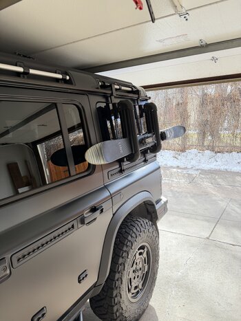

I couldn’t find a solution for a ski rack that would fit in a standard garage, so I cobbled one together myself. I used the DVA mechanics side carriers and coupled it with a Rhino Racks 3 ski carrier. All of the bolts line up and it clears without rubbing. Only down side is the back door can’t be opened with longer skis loaded. Looks clean and OEM. Enjoy.
