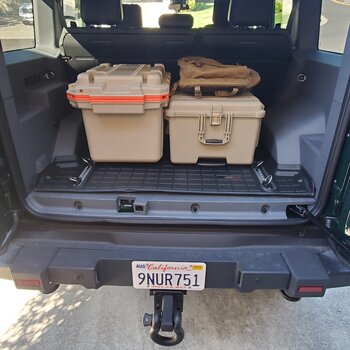

Depending on where you live in the world you either need a 50 mm or a 2 inch unit. If you live in a place that still uses Imperial units simply search 2 inch recovery shackle and find something that suits your needs. I rather liked this one.

Yes, I want something like this, but is it okay if it's not inserted deep enough
and is sticking out a lot?
And what is the diameter of the pin in mm?
if you invest in a quality recovery point / shackle you might want to secure it with a quality locking hitch pin. The Class III hitch pin is 5/8". 5/8" is 15.88 mm but these are generally purpose built and interchangable.
My recovery point was longer than I liked and stuck out further than I preferred so I had a local machine shop cut it down. The Grenadier receiver is fairly shallow, you might want to compare your hitch depth with the recovery point you are considering.

If you are recovering someone or being recovered you are better off using the two recovery points either at the back or front of the vehicle as these are intended for that purpose. It’ll be much safer especially with snatch loads to use these recovery points with a bridle strap to spread the load
