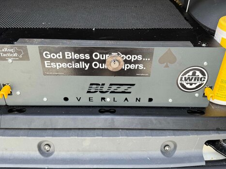

I had the same issue with the Grenadier. I previously had a TruckVault in the bed of my Tacoma for my long guns and other gear, and it worked very well. I tried repeatedly to speak with someone—anyone—at TruckVault, but they simply did not respond.
I looked for other solutions, but none satisfied me, and ultimately I compromised. I purchased the Buzz Overland side-by-side drawers, drilled one, and added a high-security Medeco cam lock. The Buzz Overland drawers have a lip on the top edge that allows for the installation of a cam lock.
The side-by-side configuration does not allow me to store a long gun (the compromise), but I am able to store other types of equipment. Overall, I am content with the purchase and modification. What I particularly like about the Buzz drawers is the ability to add additional Buzz systems if desired.

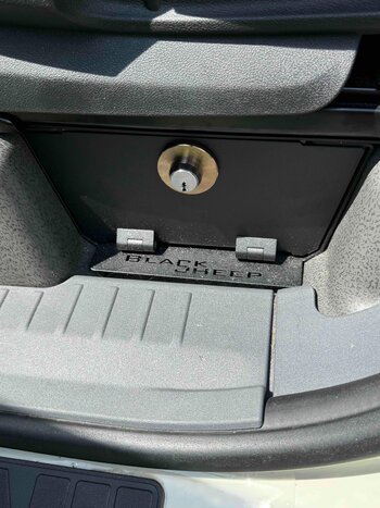

As one forum member mentioned, Black Sheep offers an under-seat safe. I purchased one, installed it, and replaced the lock with a high-security Medeco cam lock (keyed the same as the other Medeco locks). Happy with the purchase.

Hey Leon ,
Great idea on the lock . I was thinking of the same solution and came across your post .
Hope you don't mind me asking some questions .
Any idea what size cylinder will work best ? Ii.e what is the distance from the face of the drawer to the inside of the lip?

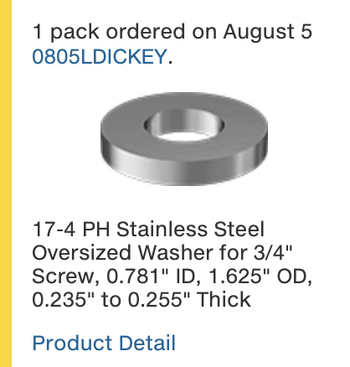

I see you used a spacer on the front is that to be able to tighten the lock nut at the back of the lock ?
Thank you !! Getting my drawers next week and keen to order all the hardware in advance .
Regards
Tinki

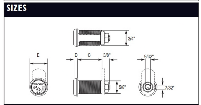

Hey Tinki,
Here are the approximate measurements in Imperial:
• Drawer face thickness: ~0.15”
• Inner drawer lip thickness: ~0.17”
• Washer thickness: ~0.235” – 0.255”
For reference, I used a 5/8” body length based on these numbers. You can see additional cylinder-lock specs in the diagram below. I also recommend selecting the 180° rotation with two key-pull positions, which allows the key to be removed when the lock is either fully locked or fully unlocked.
As shown in the diagram, the lock body is threaded and includes a retaining nut that tightens from the inside of the drawer face.
You’ll just need to drill a 3/4-inch hole in the front of the drawer to install the lock.
Best of luck,
Leon

Absoloute Legend of a man !!! Thank you !! Greatly appreciated.

I am still waiting for my ordered Buzz system 4. Almost didn’t buy it due to absence of lock. But I noticed the lip and thought I could just add a lock. Other than a medco lock, what other brand of lock did you have in mind?
Only Medco, no others. Good luck with your project, hope you get it soon.
