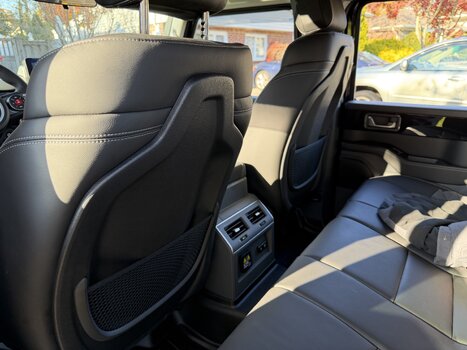

Seat Back Pocket Discovery
I found the seat backs on eBay for half the cost of new and scoured over the pictures to find ones without broken clips. They both arrived with broken clips. Refunded through eBay and bought new through FCPeuro. Tried carefully to remove with appropriate tools, both retaining clips shattered and one clip broke on each seat back. Installed the lumbar support without any fuss and with new retaining clips the new seat backs snapped in and look great.

BMW Part number 52-10-7-372-296 is for the back with vertical slot / gap in the middle upper for an X1 BMW table attachment. Not correct for the grenadier - the table is not very heavy duty so even if bought would likely not work well when off-roading.
Correct BMW part code is 52107351931 which is the one with map pocket but no slot / gap for the table attachment.
PS I have a spare one with a gap for a table should anyone wish to purchase or I can on-gift... ;) Sadly was ordered direct from BMW Germany so I can't return it. The other one is on order now.

I installed a lumbar bladder today in the driver's seat. Even with the directions above, I still lost both white push-clips and both top-side-clips. I haven't figured out why the seat back needs to be a consumable item if it's removed- nor have I figured out the purpose of the unnecessary white push-clips. Soon, I'll install lumbar in the passenger seat and find out if I'm any better at this.

I wrecked my original taking it off on the drivers side to replace with seat pocket variant. Thought I’d broken one clip, but did one side one and both bottom ones just hanging on. And I couldn’t extract the white clips without killing them too.
I’ll have to see if I can do better on the passenger seat.

I got my dealer to install mine and he said he broke most of the clips when he took the original off too.
