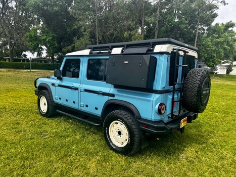

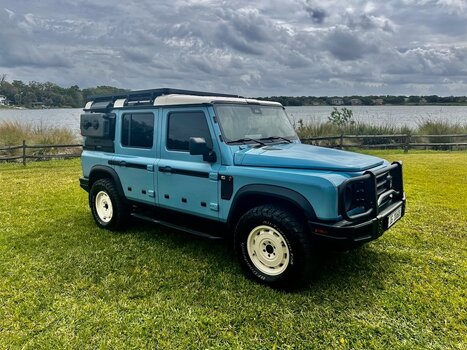

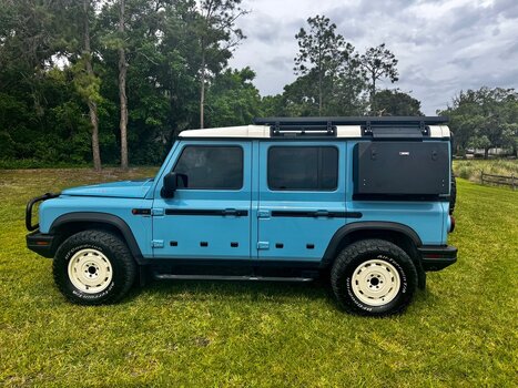

Keep drivetrain stock and put on some AT 33”s (285/70r17). Why risk CV boot failure?
The grenadier is a mountain goat with lockers. Good driving skills will get you through all but the most challenging rock crawling without issue.
Enjoy the Colorado trails! I’m shifting my grenadier back to Colorado from Florida this summer :)
