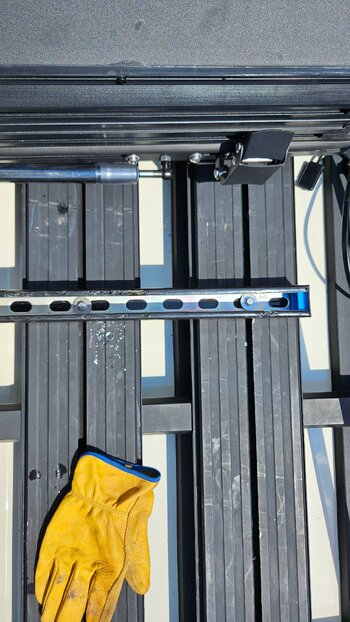

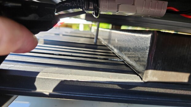

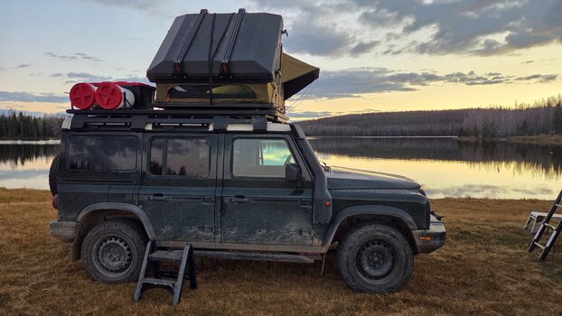

I couldn't get the official rhino rack tent rails in time for my first trip after I got my tent so I used the deeper 1-5/8 unistrut channel I picked up from Home Depot. Covered it with gorilla tape including the plastic end cap inserts. Then the u-brackets from the OEM tent were able to be clamped around the unistrut bar. Recessed under the tent so you really can't see them. Tent is raised off of the rack and I was worried that it would whistle or be extra noisy. No issues. I'm mean if there is a wind the Greeny is noisy inside for sure but it's not tents fault. Been on two big trips from Texas through to Wyoming and back and then to Palo Duro Canyon and got REALLY off camber and tilted and no problems. Probably one day will get the real bars next time I take the tent off. Mine's pretty heavy and requires extra hands to take on and off. Even at 1-5/8" I couldn't get some of the u-bolts tightened without the help of some skinnier arms. If I remember correctly I STILL had to drill a few holes in the wide part of the rhino rack slats so the u-bolts would would work. I
