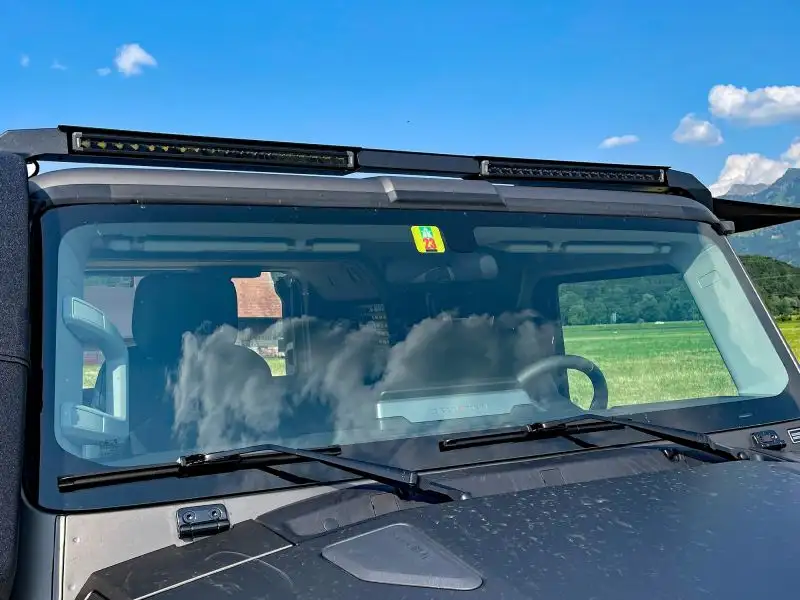

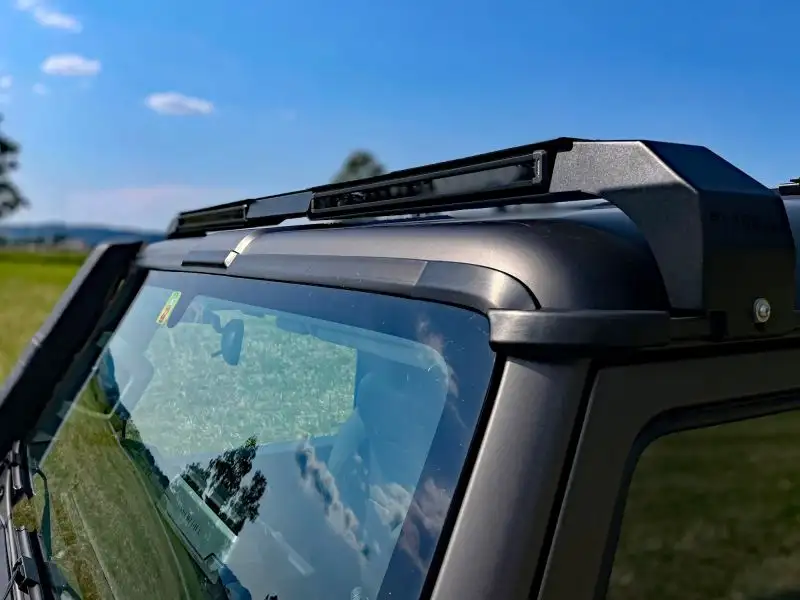

I just placed my order with Black Sheep. Dollars aside, my concern is that the thin gap between the roof and the bar is going to sing like a kettle on the Highway - the upside is it might drown out the vibrations people are talking about at 110kms - meh, maybe time will tell.

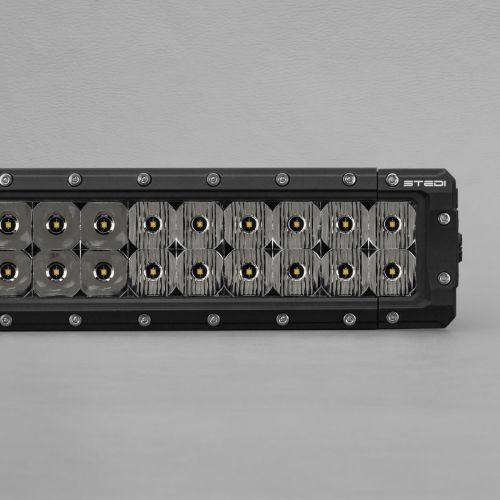

This is what's going on my car, it's currently in transit:
I am mounting it to the front of my roof top tent.
About 4 times brighter than the black sheep option including double the 1 lux distance plus at a 5th of the cost, but of course not including roof gutter mounts, but I feel like you could get those separate.

I am going with the 42” version, to try and slightly tuck it between the roof and Rhino Rack.

I moved my Ineos cross bar and (under-fitted) Ineos light bar back behind the safari windows as it was way too noisy (wind) at the front of the car. However I had to flip the light bar to bring on top of the cross bar as there wasn’t enough clearance underneath the cross bar if placed by the B Pillar. I also added rubber strips to help noise reduction.
So it’s now behind the safari windows and works very well and with little noise.
I don’t notice any major light coming into the cabin, but you can see it beaming over the top of the safari windows if you look up, but it’s not distracting.
