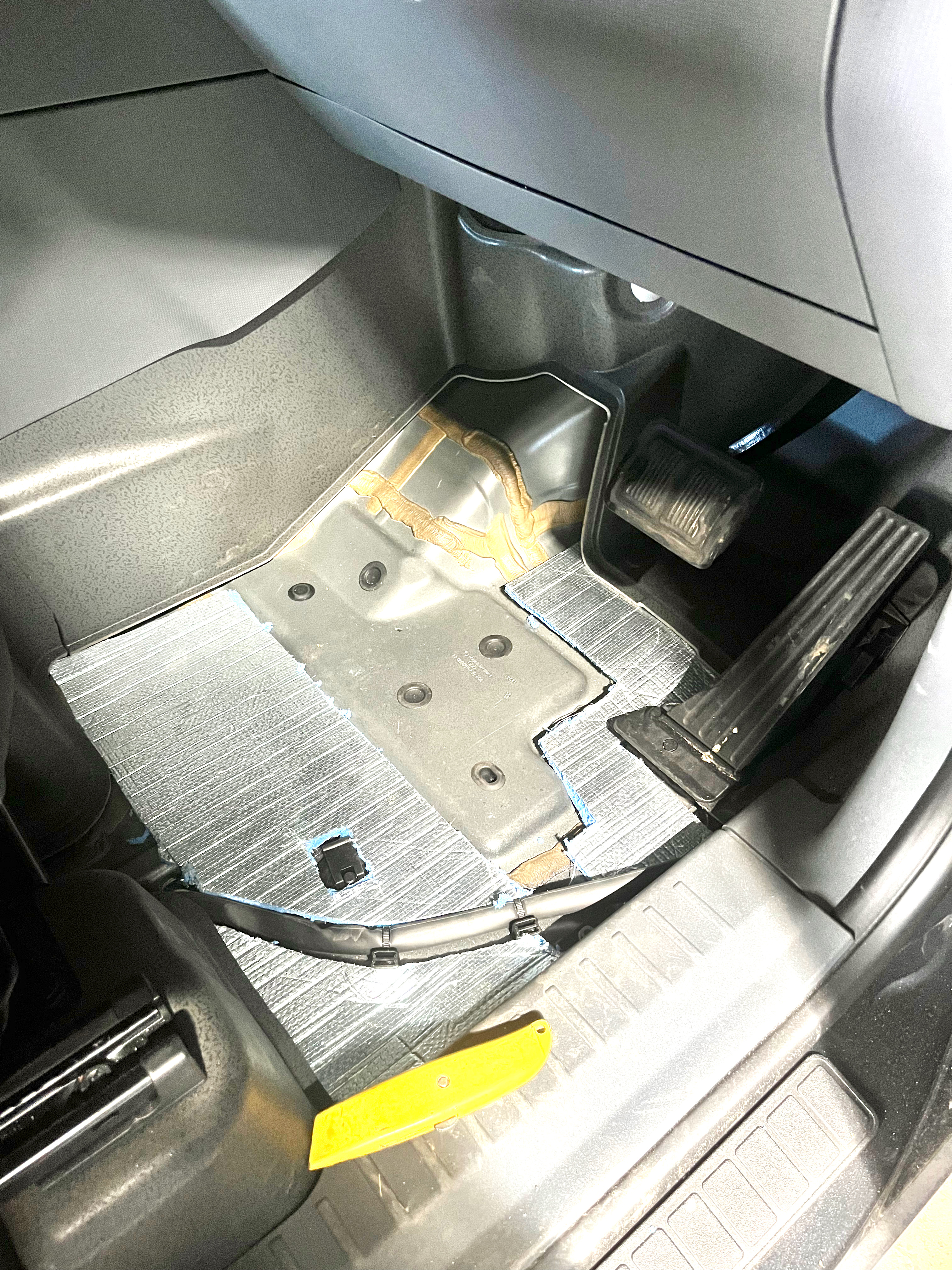

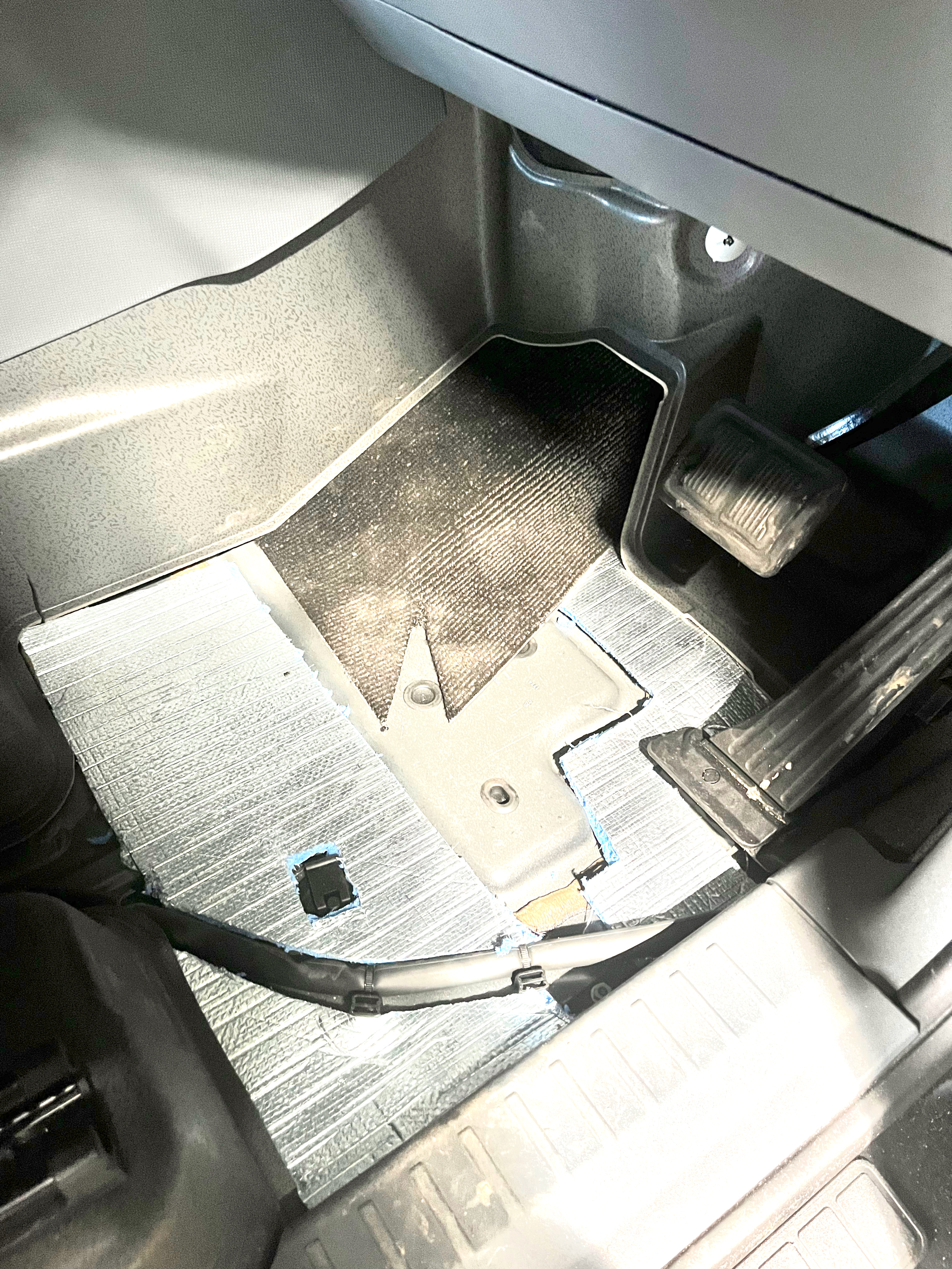

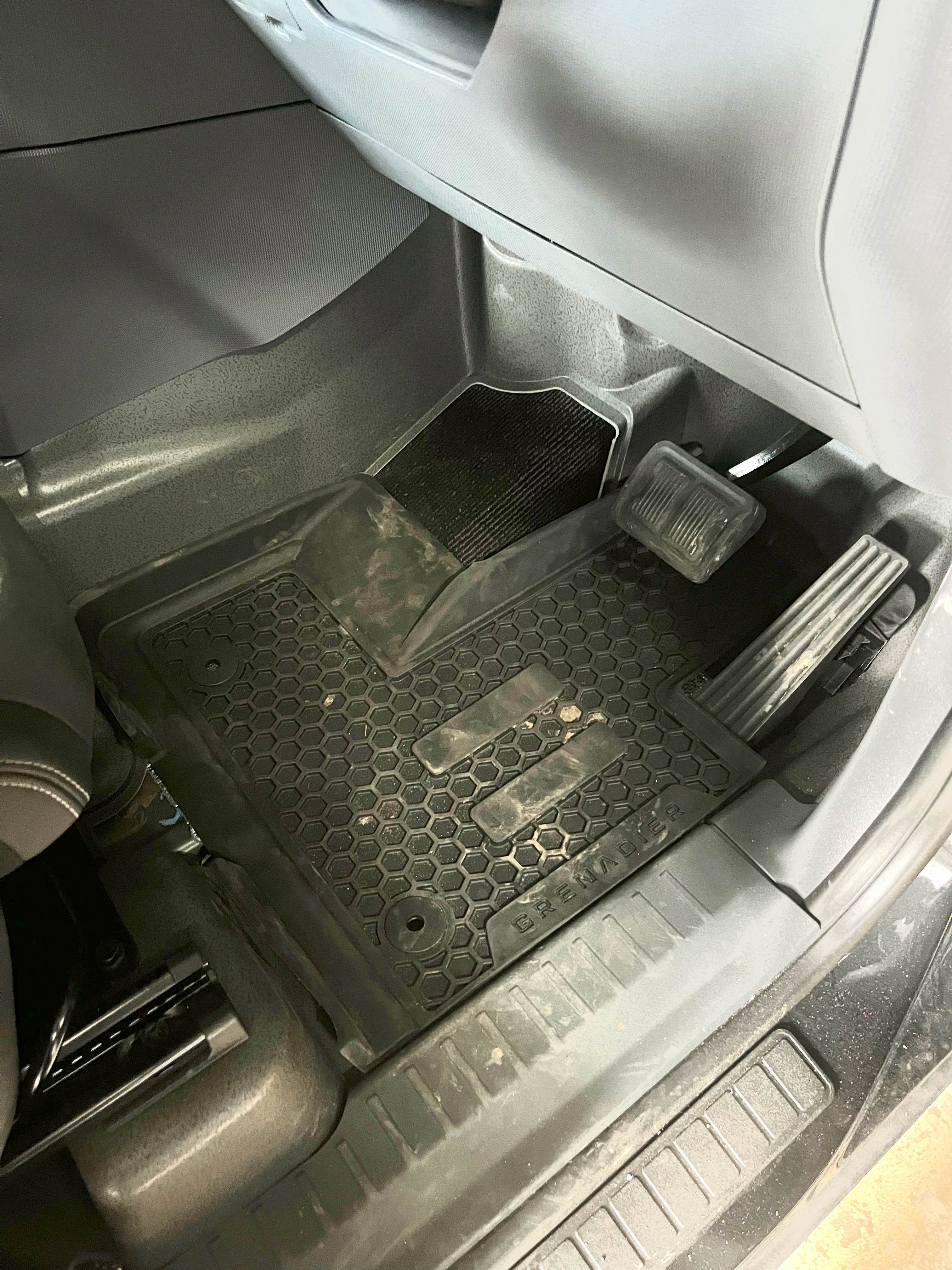

I have put about 1500km since I have removed the floor piece. No difference to noise, or heat that I can tell. Has been driven in hot environment in Far North Queensland. Hump didn't bother me until I re-injured my back, and the sciatic pain was amplified by the Left foot being elevated. Just placed closed cell foam in the low spots. Added a rubber backed carpet scrap over the metal intrusion. It is held in place by the plastic panels that I just tucked it under. Rubber floor mat placed on top. Both feet are level now when on the floor, and no more pain in my leg. There is room to fit my size 12 boots next to the brake pedal to stretch out also.
