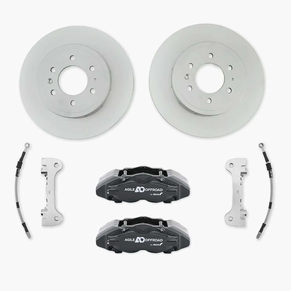

Glad you’re safe. If you do a lot of long descent driving at altitude- in addition to the suggestions above, you might just want to seriously consider upgrading your front brakes. It sounds like you were in low gear and trying not to ride them, so at some point, it’s just a question of the limits of the stock build.
That’s a great suggestion. I think the Grenadier is under-braked for my use. There’s only so much you can do after dropping it in low range and riding the first few gears down the hill. You still have to pulse the brakes to slow momentum. Thank you!
Yes - you kind of need some “mountain goat” support to the stock build. Often have those same issues here in Wisconsin on the Driftless Massif. I’ve gotta take that 50 feet of vertical at a slow crawl, which is rough when I’m getting lapped by a local farmer on a John Deere. White knuckler, let me tell you.
I am not convinced that an upgrade will make a massive difference.
Brake cooling primarily relies on airflow to convect the heat from the rotors which will undoubtedly be an improvement at speed.
At slow speeds the airflow is negligable so adding an inch in rotor diameter isn't likely to improve the situation significantly.
