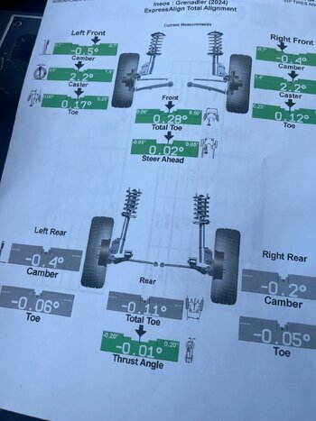

Had alignment checked this morning - front caster was 2.2 on both sides. Also had them verify tie rod/drag link, just in case I missed something.

The only things that changed prior to the issue was the installation of the Fox shocks, and put winter tires (Hakka 265/70/17) and rims back on. Rechecked the torque on the wheels. Ran the winter tires/rims last year with the Fox stabilizer installed with no issues.
Has not happened since, but a bit leery driving it. The two times (12/14 & 12/30) it happened, I was on highways, about 72-75mph, and passenger front took a small hit which started the heavy vibration and steering "fight".
Going to try to inspect bushings next - but really scratching my head.
