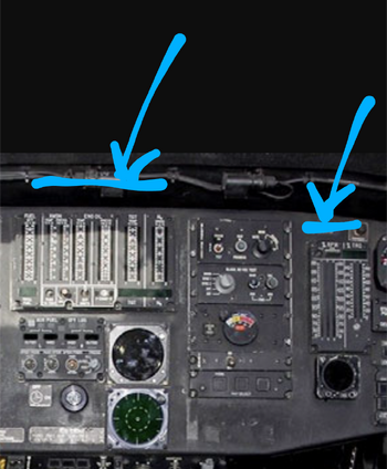

Sharing, not arguing.
Sometimes folks just like to know what's going on.
Years ago the Sikorsky company trialled a mock helicopter instrument panel that took away all green/white, normal, good, expected indications. The hypothesis was if it's a normal or expected condition there is no need to display it. If something goes from normal to an abnormal condition, like a rising gearbox oil temperature, then display an amber or red indication as appropriate.
The trial crews hated it.
Paranoia is ops-normal for helicopter crew and particularly crew operating over water.
The trial crew fixated on the blanks:
'Is it off because everything is normal or is the system broken?'
'How do I know the monitoring system is working?'
They were happy to keep scanning the additional information as part of maintaining situational awareness.
The trial contributed to Sikorsky's development of the Vertical Information Display System (VIDS) introduced on early UH60 aircraft to condense operating data previously displayed on analog gauges, into vertical illuminated LED display stacks that could be scanned horizontally by the crew. The VIDS concept later evolved into digital Multi-Function Displays (MFD) that are common on modern aircraft.
Guessing a helicopter pilot is way more switched on mechanically than the majority of drivers and gravity is a major part of the paranoia.
There are a lot of 12 o'clock gauges in machinery with green and red markings. If the needle points near 12 o'clock at a glance all is ok.
