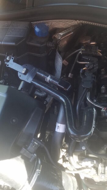

So I have installed an oil catch can and will drive around with it on and see if it does any good. Since actions speak louder than words I will
see what if anything happens.
It already has an Hengst disk type centrifugal catch can .
As has been documented elsewhere look on their website for function.
