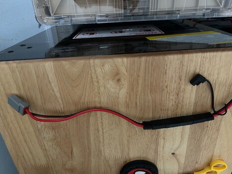

How did you wire it? The pump is has an SAE connector, but how did you get the roof tied in?

I wanted to keep the SAE connector on the compressor side, just in case I need to use the battery connection at some point so I bought this
and this
and this
and connected the DTP-2 connectors to the SAE cable I bought from Amazon, I had to use the polarity reverse adaptor that came with it. Here is the end result.

I figured this out later on yeah, pretty easy! it works great.
