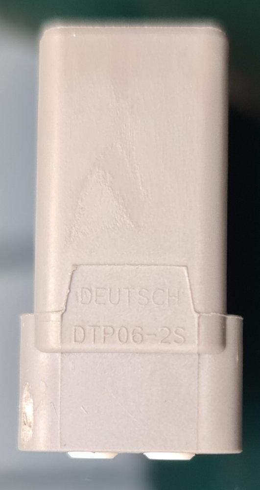

In one of the previous posts I showed the Deutsch Connectors I bought on internet. I thought all these connectors were compatible. Yesterday, to my dismay, I noticed that my connectors are slightly different from those of the Grenadier, very slightly.
Dismay, not because of the money (11 euro for 8 sets) but for the time I spend preparing some stuff.
The Deutsch connector types you should buy are:
  • DTP06-2S (male housing, female pins)
  • DTP04-2P (female housing with male pins)

Thank you.
Useful post as i was about to buy some.
