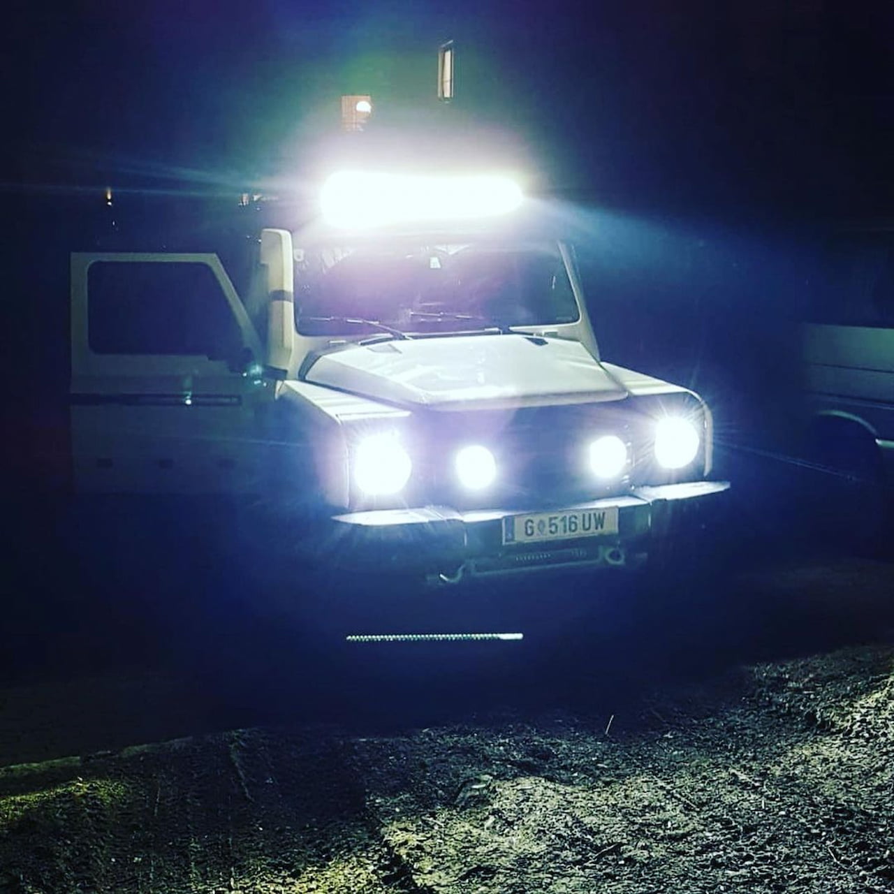

Light bar in action - seems to be knocking a little more light/power at each end:
