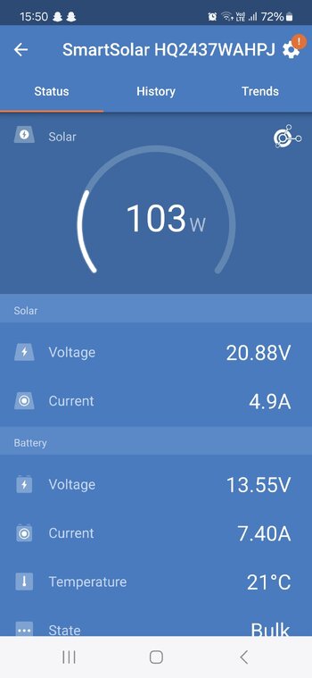

So, this one ended up with the full works.
Ready to run 400w Solar panels using the MPPT100/30 with 6mm2 PV Cabling to an Anderson PP75 mounted next to the roof plugs.
I've also removed the auxiliary fuseboard power and placed it onto the leisure system and fused it, now allowing the light pods and roof tent to be powered via the leisure system. Added some hidden 12v ports in the bottle jack enclosure. This system is fully hidden from view in all aspects. Very pleased with how it turned out
