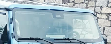

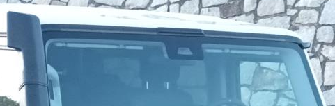

The glass is different (the dark surround goes around the area of the ADAS box at the top of the windscreen.
Plus, the upper seal/frame piece (not sure of the specific name) is supplied with a new windscreen. They frequently break when the old windscreen is removed, and Ineos supply the seal with the new windscreen. I don't know if the frame piece is different. Here is an MY23:
Here is what is claimed to be an MY25 with ADAS but appears to be missing the frame piece - every new vehicle from that dealer appears to be missing it (VINS in the 24,500 range). But their older vehicles in their stock have it:
And an MY24 with ADAS with the frame piece:
The difference in the ADAS, non ADAS is clear to see. The frame piece is interesting as it appears newer builds don't have it. (My July 2024 build has it)
