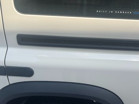

If I cannot find the INEOS nominated torque, I look at general torque values like this:Would be great, if anyone would now the needed torque. I had to place mine from the M1 setup to the N1 setup to make the drawers fit ;-)
