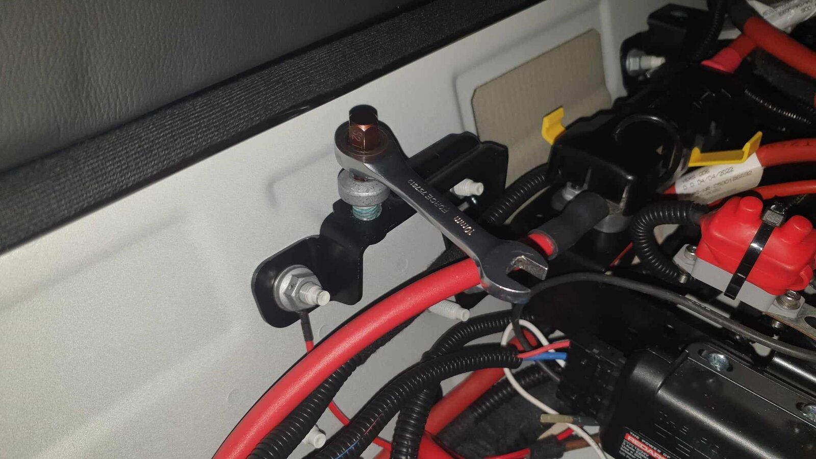

What size Torx is this screw at the cover of the battery compartment?
T40 or T45?
(Picture taken from a forum member found elsewhere, not mine)
Edit: Found it, seems to be T45.

Do you know if that is from a 5 seater model. I have a 2 seater and it does not look familiar to me.
I will look tomorrow.
T40 or T45?
Sorry I cannot help, this bracket does not seem to be on a 2 seater model. Ask @DaBull, he may be able to help.
