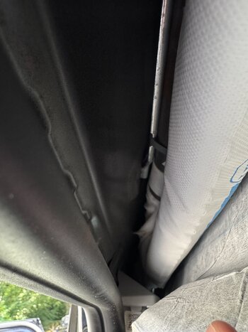

Now I need to figure out how to get from the top of the B pillar out to the roof via the grommet for the aux power. Any ideas? Do I need to remove the roof trim? If so how? 🫣
I’ve managed to peek behind the roof trim, just on the other side of the roof DTP plug and I can’t really see how I’m supposed to be able to feed any cable through here…
Help gladly received….

I assume this is a view forward and you are looking at the side airbag? if you must go forward, you will need to take care to route your wire above and out of the way of the airbag's path of deployment. You might have an easier time if you route your wire out the back outlet. This picture shows the run (but on the other side). For my antenna coax, I did not drop the headliner myself but @Jean Mercier's picture shows it partially dropped to gain access. For a current-carrying power wire, i think a good routing would be to zip tie to the existing DTP plug power wire as shown in the picture.
So it’s easier to go through the rear outlet because of the airbag. Makes sense.

I think not. But the tricky part is to feed the cable from the outlet to the B-pillar, considering the airbag placement. I think one needs to remove more of the ceiling trim than I managed.
