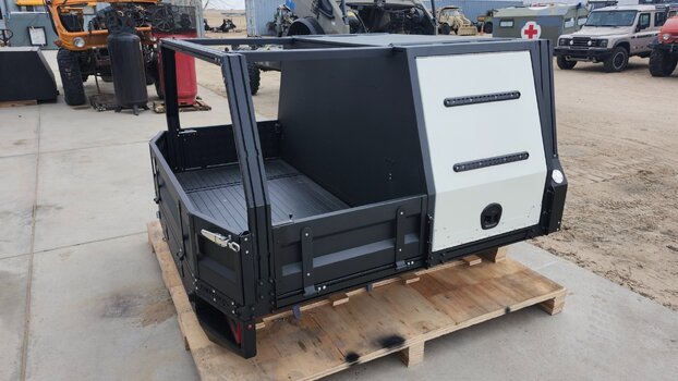

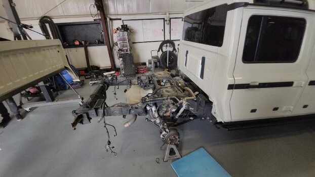

Here you go folks, the process has begun. Jay Couch has called me each day to provide an update and provide what they are looking to accomplish on the given day.
Yesterday was weigh day and beginning to disassemble. Starting weight was 6300, his goal is to keep it just a few hundred pounds over 6300. The bed is extruded aluminum which is different than what he did on V1 which was a flat piece of aluminum with two channels. Want to make sure everything lines up before assembly.
I had him paint the half box to match my Scottish white. I mentioned the drop down panel need to be painted but now seeing half box only painted, part of me is keep as is. Tell me what you think?

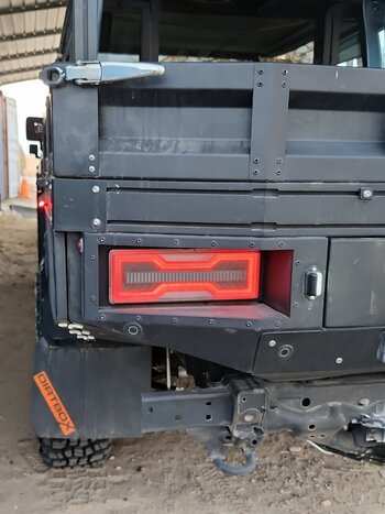

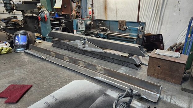

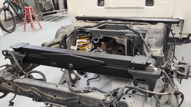

Today's pictures, what my taillights will look like. Floating Sub frame. Rear winch installed,no picture, cable ran all the way to battery in cab. We decided to by pass the NATO plug so I could run the winch in case emergency with no power. Carbon winch comes with a isolator switch and that was installed too.

Well here you go, pretty much done except mudflap, water pump connector and some rear facade work between the tray and winch. I told Jay that we should call this build Project: Jaeger which is german for Hunter but also the name of the Mech Suits used to hunt Kaiju. Little play against the Aussie Kaiju build. I'll get a video walk around done when I get it back and I install my bull bar and front winch. The tray weight, winch and half box only compressed my suspension less than a 1/4 of inch. When he was setting up the fuel lines, I mentioned a post from FB about the Evap canister. He then moved my Evap to the head rack to make it easy to service. I tried to be as thoughtful and forward thinking with thao build
Jay updated the springs to Eibach HD 500. He took it around to see how it all works. Tomorrow it gets weighed and the last bit is the skid plate/underbelly tire holder. My guess is the tray, half box, rear winch, 2 renogy slim state battery, control hub and redarc 40DC to DC, empty 19 gallon stainless steel water tank and to side boxes: 632. Original weigh in was 6300. Toss your numbers below.

Looks incredible. What was your thought process to leave the back 1/2 open vs. a completely enclosed unit?

Modularity/flexibility is the main reason. The truck is my daily and used for so many different things. I went back and forth for a year about what I wanted my set up to be. The half box works best as I can still use the bed for muddy items, garbage runs, dog kennels, etc. then my camping set up, I will run a ARB Element fridge, and two roam boxes. That still leaves me about 11 inches in length and about 6 feet width of open outside space. The half box can be used for stuff I want to keep clean.
