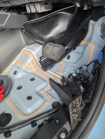

This is the floorpan under the right side front. I'm in there currently doing a speaker upgrade with a small crossover. Example only.

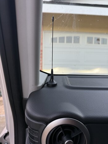

Thanks guys, I pulled the floor mats & found a few of those grommets, but was running out of time & daylight to fiddle with those today. Got everything wired up to Int-1 (including mic pass thru & additional usb power ports on both sides). Used the little magnetic antenna that came with the kit on the corner of the dashboard just so I could test everything out & button all the dash panels back up for the day.

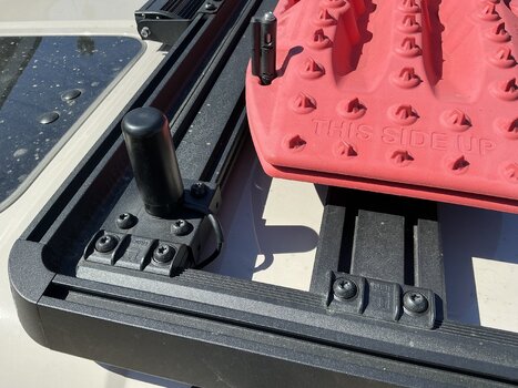

Will revisit the antenna issue another day, still not sure if I like my original idea of the ghost antenna on the hood mount bracket or if I just bite the bullet & go for the rack/rail mounted folding antenna route.

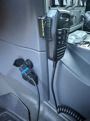

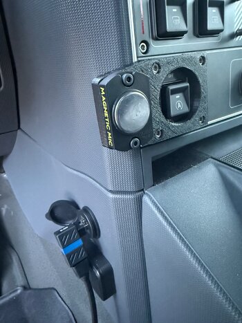

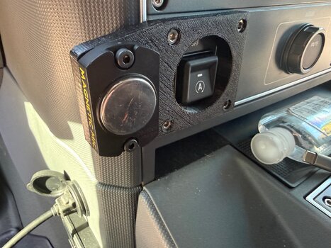

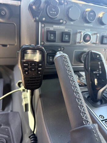

Haven’t run the antenna wire up to the roof rack yet, but I did 3d print a prototype bracket to mount the magnetic mic holder. First design in Tinkercad so could use a bit of finessing but fits well & keeps the mic close to the center console.

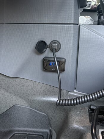

Got the antenna wire routed through the driver side power outlet grommet, down the B pillar, along the floor & up to the radio unit behind the steering wheel. Everything up & running - nice clean install. On to the next project !
