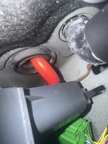

These are the best I can do for pictures with my dumb phone. The grommet is located on the far left of the firewall very close to the fender. It's installed from the engine compartment side and very difficult to reach. This first image is looking straight down in the very rear left corner of the engine bay. You can see the grommet with the line I ran through to the rear of the vehicle. Below that is a larger grommet with (I think) the hood/bonnet release cable. Below that are some Autumn leaves stuck to the silly fiber batting that covers the inner wheel arches. Sorry for the fingers. I was holding a flashlight.
On the inside the hole is located just above and to the left of the LHD foot rest. I wasn't feeling especially patient when I ran a wire through it so (following someone else's advice) I pushed the grommet out from the inside, then retrieved it from engine bay, and installed it inside the cab and pushed the line through it from there. The grommet hole is fairly close to the 800mm waterline set by Ineos so iirc I put a little RTV sealant on the grommet before I pushed it into place.
