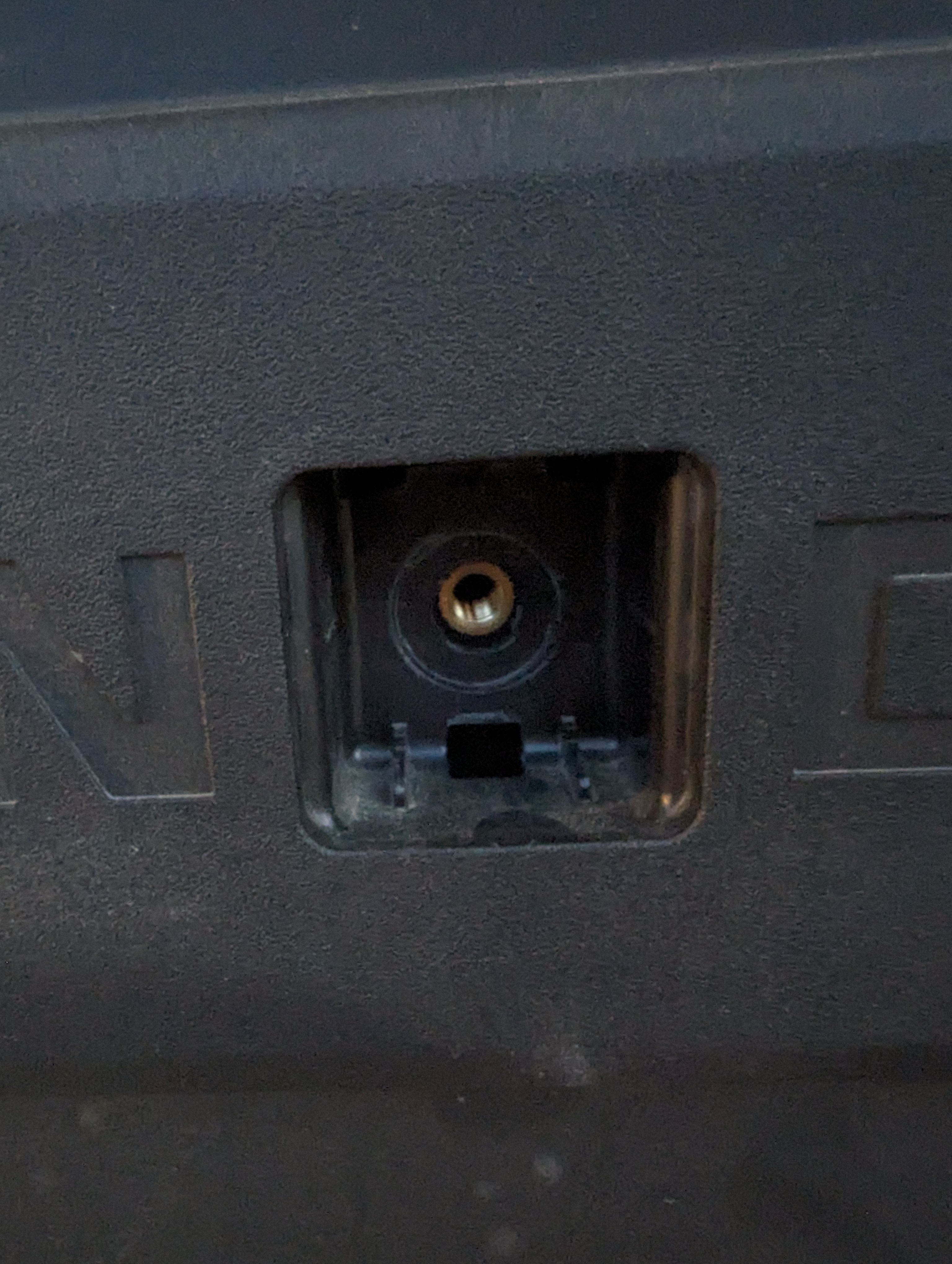

Finally took the spare wheel cover off mine. 10mm hex bolt, is the brass insert what spins to prevent the cover from coming off or is this an updated design on mine?
IIRC the old design was a Torx and a plastic insert

I decided to take the mount for the cover apart and see what was going on.
It turns out the bolt was not stripped, however it was screwed in so tight that the brass fitting came unglued from the plastic mount. (Photo 2) This explains why it would just spin and couldn’t be pulled out even with tension. I put the casing in a vice and still could not unscrew it, so its really tight.
What I did for a short term fix, is insert some threads where the original brass fitting was. (Photo 1) I am going to make sure that is anchored in and then use a short stud with a nut to hold it in place. Once the cover is placed on I will use a nut with a washer to keep the cover on.
Yeah I mangled the plastic, but I imagined one thing was going on when something completely different was happening while trying to remove the nut.

So my problem was the nut part that is embedded in the plastic is what came loose. The 10mm bolt is definitely easier to deal with, but it doesn't help if the fitting in the plastic is shredded. Just make sure you can unscrew it and then don't over tighten it...
