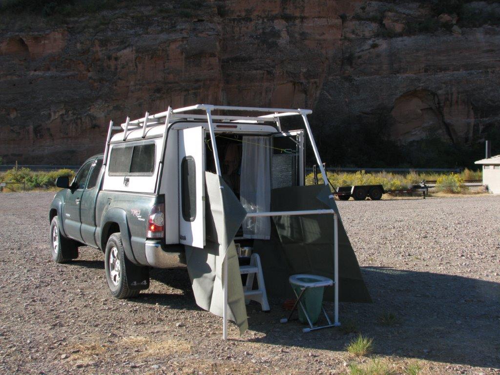

Cheap solution was to attach PVC pipe to the roof rack with outdoor duty cable ties. There are two PVC diameters that telescope well. There's a U-shape that pulls out of the side pieces. That can be with or without supporting posts. I angle the supports to drain off rain. I use ballistic nylon for shade and small waterproof tarps for rain. The PVC pipe and some fittings are ordinary schedule 40. I forget the two telescoping diameters. The angled and sling fit fittings are mail order from PVC furniture and PVC greenhouse suppliers. One morning I pushed in the U shape but forgot to secure it and it came off on I-70 in MO. Quick trip to Home Depot and voila. I had to fudge the sling fits until I could have more shipped to a friend on the way.
