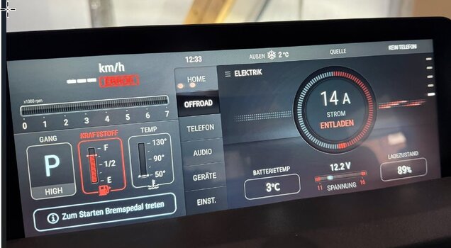

What % charge is the battery showing?
Battery is at 89 %
Is the fuel information normally red like that? Could that have something to do with it?
I think you have a faulty battery.
Note that the SOC is a measure of current in/out and is unaware that your battery may have a fault.
The reading of 12.2v suggests the battery is between 25% and 50% charge. If you fully charged the battery then the voltage should be 12.8 to 13.0.
So it looks like the battery is not accepting charge, cold temperatures making the situation worse.
This problem is often caused by letting an agm battery fully discharge and then leaving it for a week or so, fairly common for dealerships to do that especially if they have been opening and shutting doors to show the vehicle to new customers.
