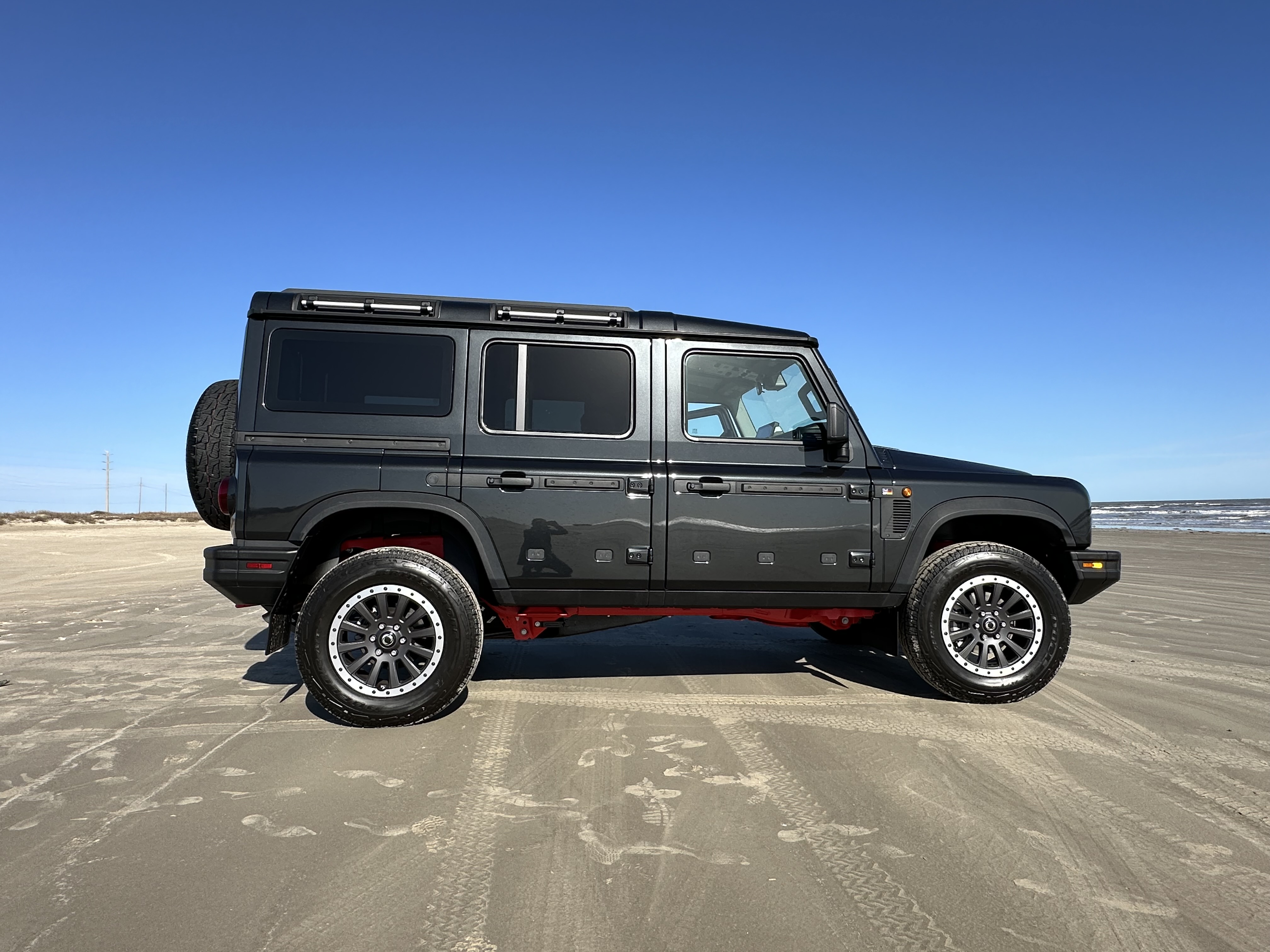

Bought an IG for my wife as well. Took delivery end of January. A few small issues in the beginning and Mossy Ineos (Houston) resolved them quickly. I can say that we love the Gren. The more you drive it ….the more you appreciate it for what it is. Looking forward to a decade and more of adventure.
