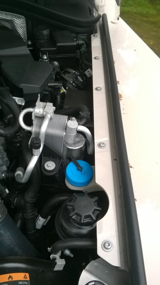

In Trialmaster with winch i cannot find the under bonnet fuse box.
Photos above are of a RHD, yours looks like a LHD. Have you checked on the corresponding opposite side?

You all think it is possible that under the coolant reservoir is my "under the bonnet fuse box?"
Trialmaster, winch, LHD
Didnt want to disassamble any further.

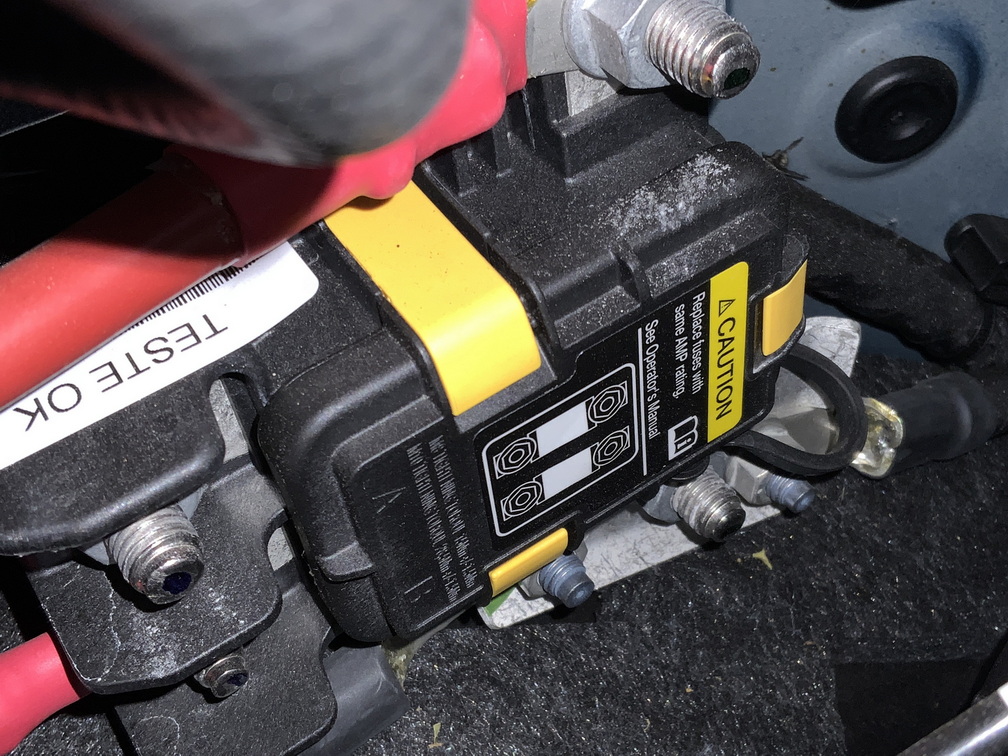

More zoomed in:

So far we are not sure if it is the fusebox. Might be something different.

Oh. How shall a blown fuse be replaced?
If it is, you would simply unbolt the 2 (3?) bolts holding the expansion tank in place, and there should be enough slack win the hoses to "flip it" to one side to access what is below

please all stay on hold.
we are not sure if it is the fuse box.
will investigate fiurther.

Well the arrowed part on this is also odd:
If it's fed off the MTA connector that also has the jump start brass terminal then it's either permanently live at one end or voltage sensitively live at the other, so one slip of the screwdriver is a nice short circuit.

So which fuses are they?
Prone to blow , or only if people muck about with factory wiring?
Anyway , it's no big deal to move a coolant tank should for some strange reason a fuse blows.
