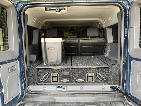

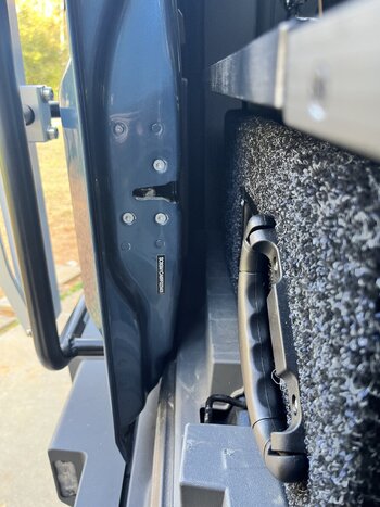

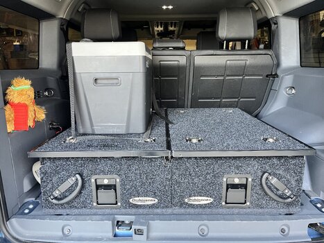

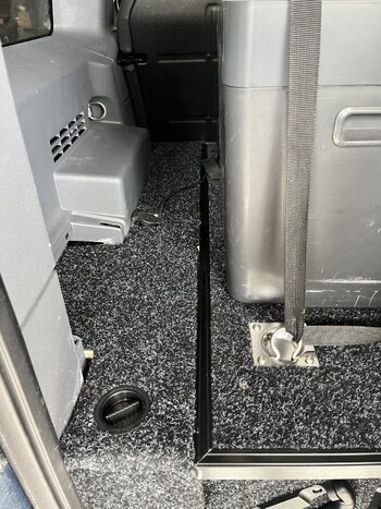

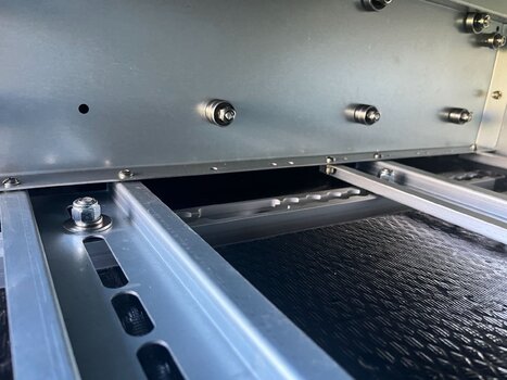

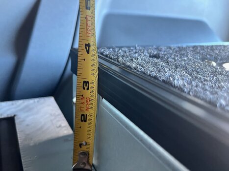

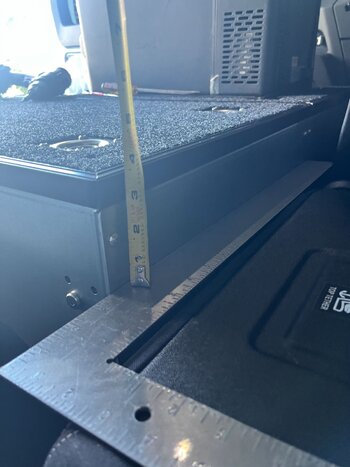

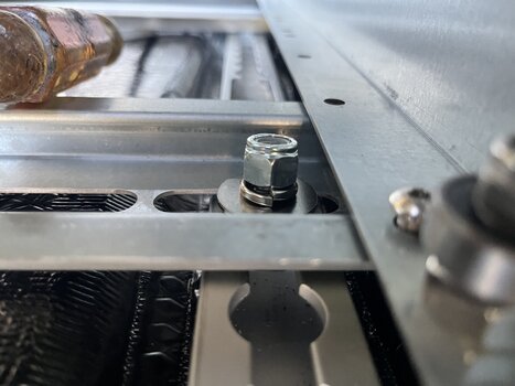

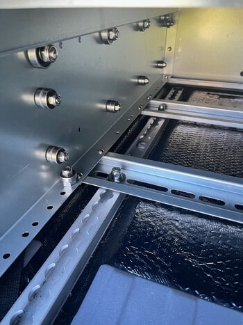

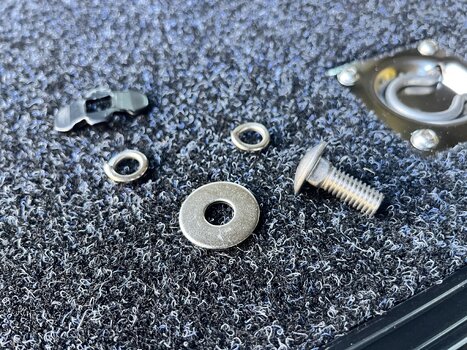

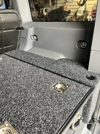

Here's how I bolted it down. Opted to keep the L-Track rails installed under the box as it made it possible to secure the box without drilling new holes. The universal wing kit is going to be some work though to finish out the sides. Also here's the height difference of the rear seat when folded flat. Sits roughly 3.5" higher than the rear seats.
I used some other carriage bolts I had laying around that fit + nylock nuts, but these bolts may fit height wise.

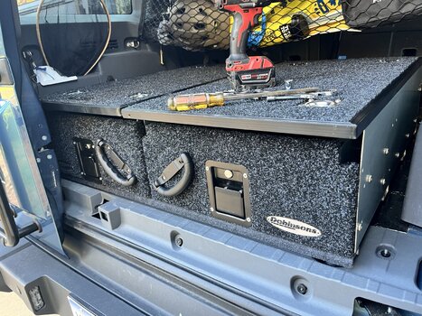

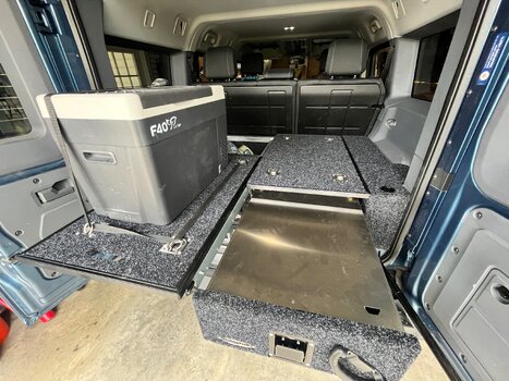

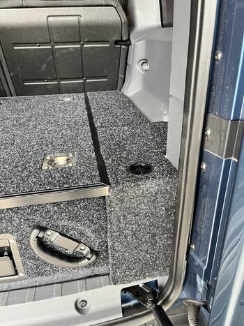

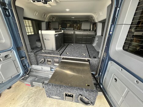

Finished out the drawer sides.

These are so similar to the African Outback drawers I put in my LC 100 a couple decades ago, that they had to have purchased the design (tooling for the stamping?) in bankruptcy.
This design is bomb proof. The rollers are way superior to the slides that are common today. I think I paid 1000 back then, so with inflation, they have gone down in price.
