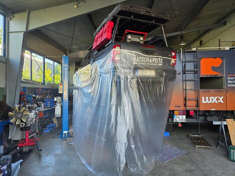

Could you share photos of before and after? Just wondering if they coated the brake and fuel pipes and also the suspension springs?Hi gents, was trawling through the forums to find a rust proofing solution for mine and decided to have the dinitrol treatment at Rustec in Wiltshire. Couldn't be happier. They left no stone unturned and produced a really cracking job. The preparation was done to a great standard and they're all a really nice set of blokes! www.rustec.co.uk
Vehicle Rust Proofing Swindon Wiltshire | Rustec https://share.google/i3jMxbMEcymrVjkh0
