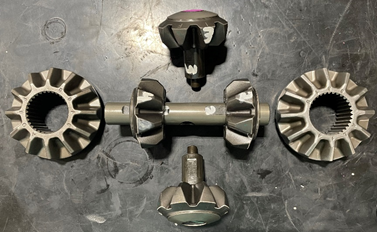

Here is a deep dive into the GKN e-locker in the broncos. I can't tell you if it is as strong as the Eaton e-locker we have but I can promise you that it is actually instantaneous and works very well. Also notice that it is just a simple 12v feed. Apply 12v to the wire and the locker engages. I wish it was that simple on our trucks. I would just wire them to their own switches and have complete control. There are situations where you want to use a front locker and not the rear.
