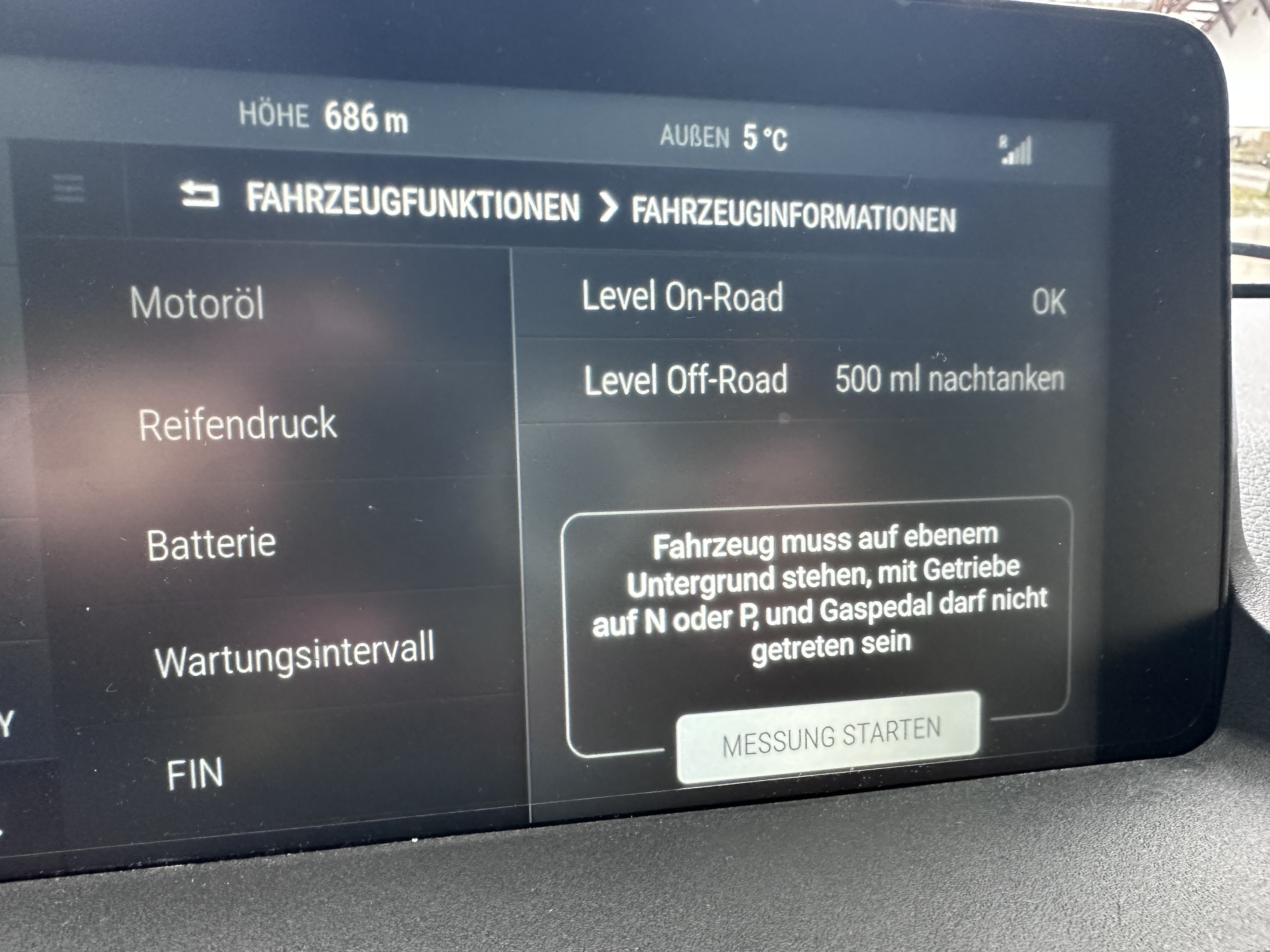

Changed the oil and filter this arvo. And cut the grass!
odo at 1825 miles. Stuck in 7.150litres of Valvoline bmw spec 0w-30. May well change spec after warranty period and go down the 0w-40 but until then will stick with what's stated.
On road oil check said '0k', off road wanted 500ml more. Exactly what it said before I changed it.

Today after 9937 km, be advised to fill up 0.5l OilIMG_6201.jpegIMG_6202.jpeg
