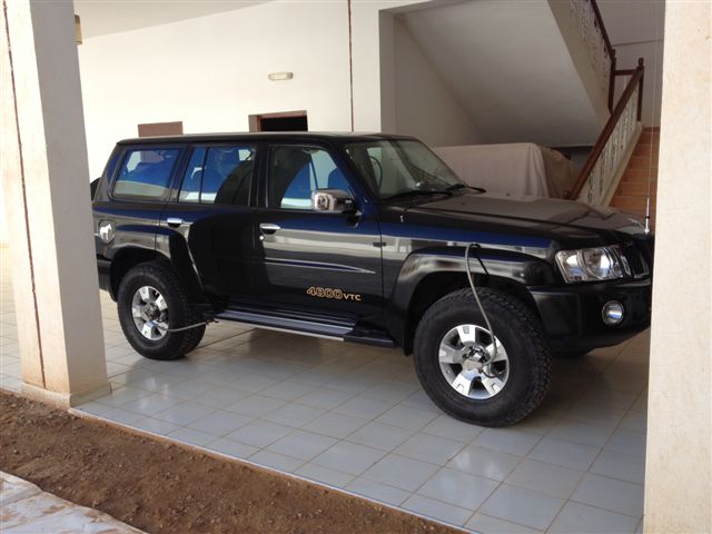

Portal hubs look like the only way have a fully integrated system fitted to the Grenadier. The 6x6 Mercedes G63 has portal hubs with CTIS. Other retrofit CTI systems have external hoses going down to the hubs, similar to systems used on logging and fertilizer spreading trucks.
