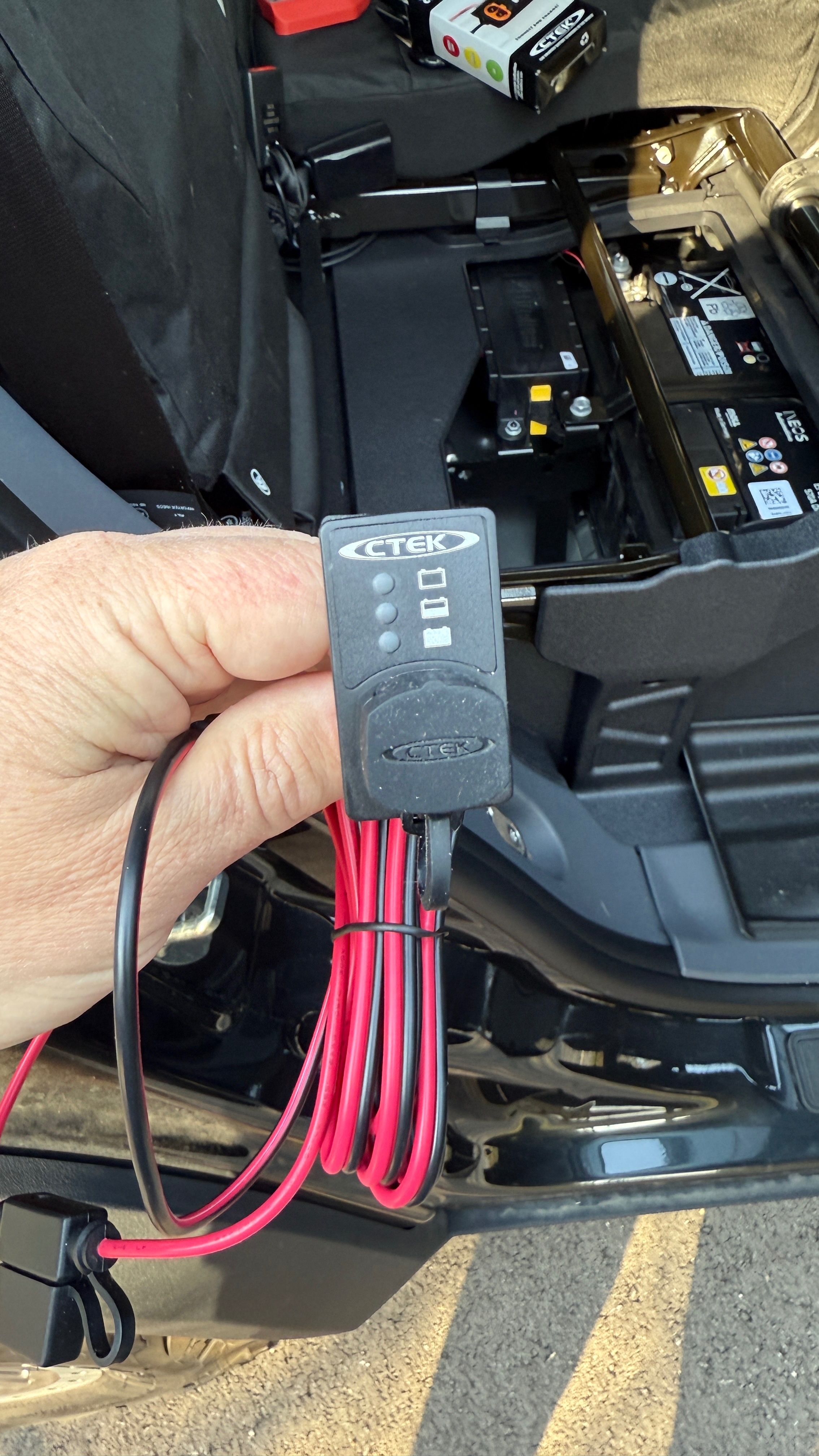

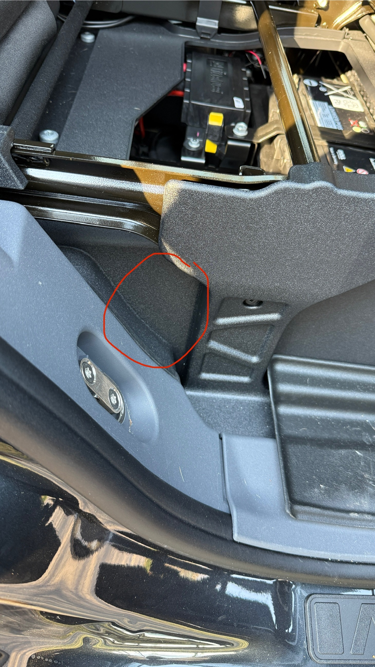

Hello,
Thank you for the help with this quick question.
I need to place the Gren on a battery tender as it will sit for long periods of time.
I want to install the C-Tek Comfort Panel Indicator.
In the photos, marked in red I have highlighted the positions on the Aux battery and also where I want to install the panel.
Does anyone see any concerns with this installation?

Easiest spot to wire the battery tender would be at the jump-start port under the hood as there is a great ground right there as well...
Are you trying to wire the battery tender only to the aux battery?
Yes, to the AUX battery. I’m trying to make it clean and the CTek panel makes it plug and play.
If I keep the AUX battery full, the battery management system “should” top off the main battery, or have I read things wrong.
I figured I would ask hear before I cut a hole and wire the battery.

Assuming any loads on the main battery are less than the trickle charging ability of the CTEK Smartpass you'll be good!
