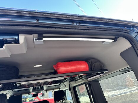

I installed the 12” light above my rear door table, very happy with it. Adding two more to illuminate cargo area one on either side similar to the red Grenadier build someone posted. All wired to INT2 with their dimmer switch for the two cargo lights. Will post some photos when complete.

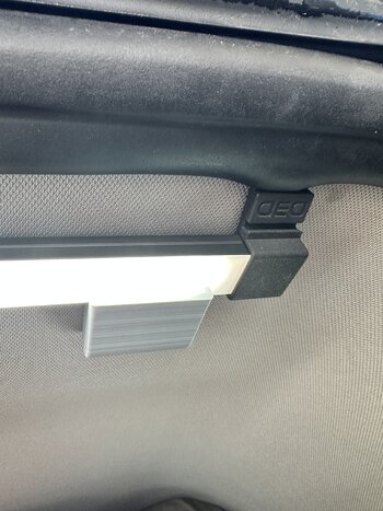

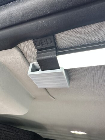

The pin spacing for the dome light and the defender light pig tail are the same, but the connector shapes are different. Friction fit is pretty good, so I did a little extra securing between those two….the other connector that would plug into the dome light is completely incompatible and I could not find a keyed 2 cavity connector that matched, I dealt with it other ways. I modeled and 3D printed 2 ‘clips’ that hook onto the headliner buttons/fasteners and let the existing tabs (intended to go under the trim in the cargo area of a defender) tuck under the rubber door trim to further hold the light in place.
At any rate I now have a lit cargo area so the dog (13yo) can see where he’s jumping at night without me fumbling for a light switch and having to recharge temp lights.
