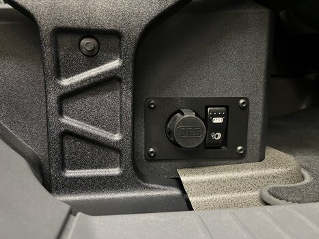

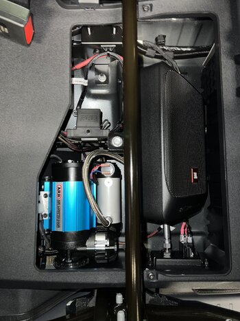

Front or rear seat compressor? I’m not your guy, I am just curious, the rear seat compressor is giving me a mental block at the moment (for the last 3 months).
Part of my problem is that I discovered one need not route the rear seat compressor to the cargo area but mount the chuck and switch to the plastic shroud on the passenger side of the rear seat.
I recently installed the rear seat ARB compressor as well. Similarly and without too much modification, I put the power switch and hose connector on the panel under the rear seat. It was a lot easier to do and a cleaner install in my humble opinion than extending the connector to the right rear panel by the cargo door.
