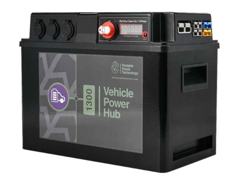

Perfect thanks @Disco Dave and @Znarfgh. I have the two seater commercial so would want a battery box in a similar location. I also have the dual battery and high load wiring. I think there is an ignition trigger wire with 40a supply that is in the battery compartment, which is there to potentially supply a compressor, so In theory I could use that ignition trigger wire if I get the portable battery box as I posted above that has inbuilt dc to dc charger.
Portable lithium battery box with a DC- DC charger works very well.
Hi Tazzieman. Have you used an ignition trigger wire or just direct connection via the dc to dc charger to one of the two Grenadier batteries
Yep, that's the trigger wire that I used for my portable LiFePO4 battery in a box with DC/DC charger.
Perfect I’ll get one like the one I posted above from 12v planet. Unless others have got a better suggestion or manufacturer
