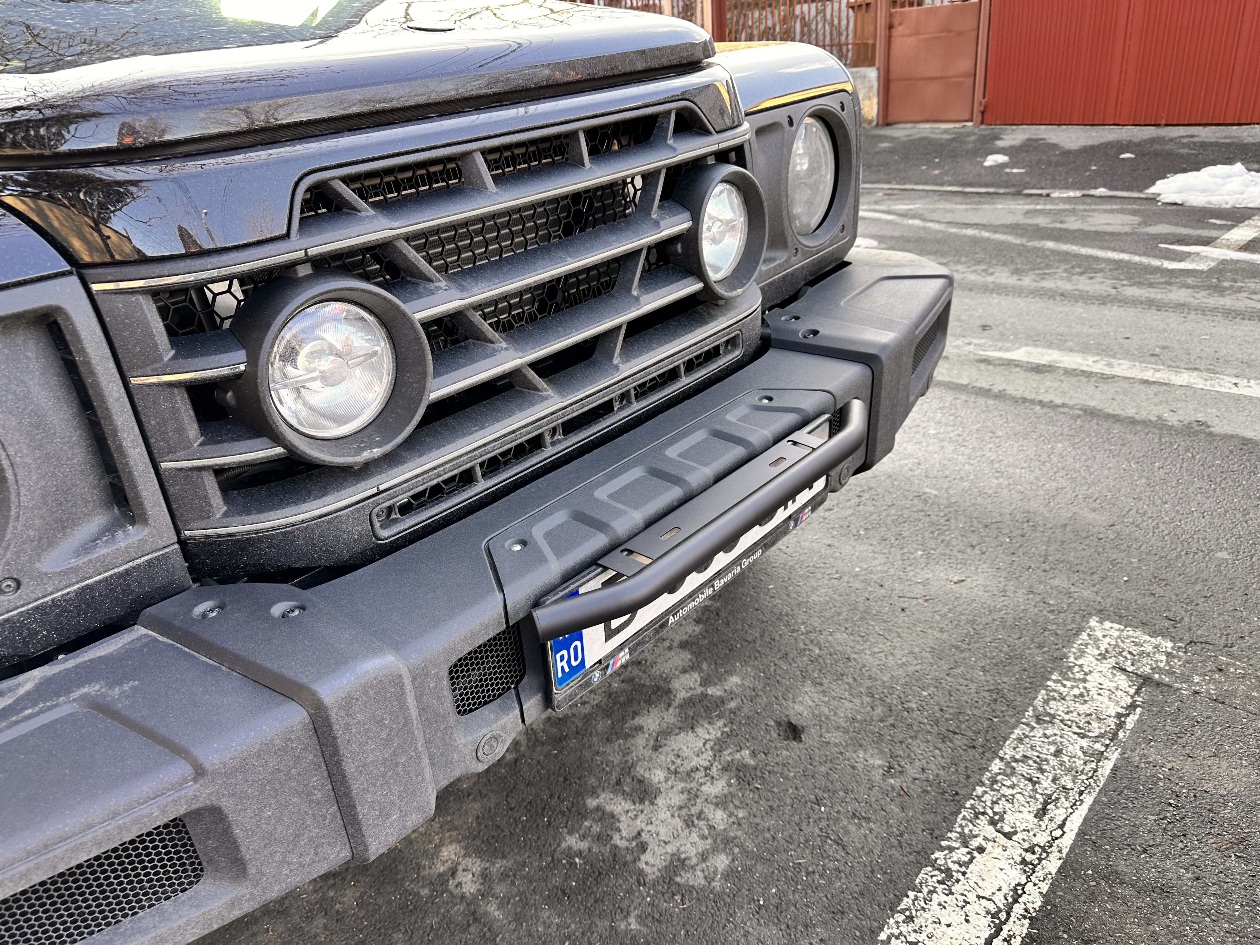

Just ordered 2 Siberia Skylord from Strands (https://strandseurope.com/product/siberia-skylord-driving-light-9/). I would like to fit them on the front bar. I also have a mount for them that ia fitted under the license plate (see picture). What do you guys recommend for the wiring? From where and how? Given that the leds also have position light (amber or white) and i would like this position light to always be on like a DRL. The led has a DT-4 connection.
Nice choice! Wiring would go through the grill to the left side of the vehicle over to where the power relays are. I taped the ends of the wiring onto a relatively stiff piece of titanium wire and used that to route the wiring through the grill.

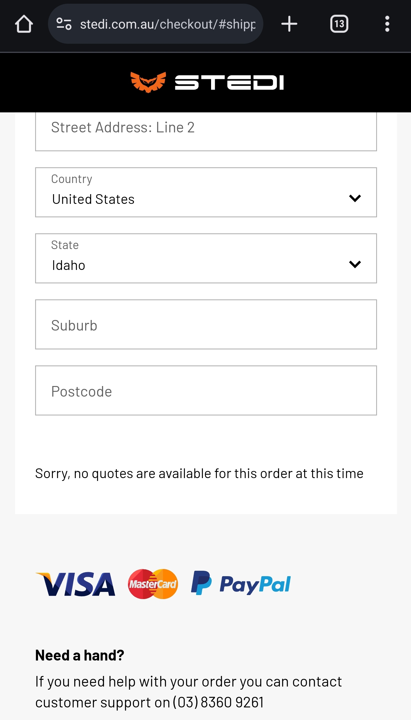

I wish these 52" bars were available in the US. I can't even find anyone abroad who will ship it.
If you use a VPN and set it for Australia, you should then be able to order it from the Australian website, which looks like it allows you to ship it to the US.
Alternatively, you could try to contact Stedi directly and ask the question.
JGM
Production/Transit
4:37 AM
Nov 16, 2023
13
18
United States
I did contact them directly. They said that it was in the works to release the longer LED bars in the US, but there was no timeframe for that happening. I'm not sure why they would supply most of their products via NAPA Auto Parts and leave the longer variants out. Perhaps it's some US governmental nonsense...
K1LL3M
7:37 PM
May 21, 2023
147
350
AUSTRALIA
Most decisions we wonder about can be chased back to government nonsense.
Use a VPN and order directly via the AU website. As posted previously the website allows a US shipping address, so I can't see why it wouldn't work. And on the plus side you get the benefit of a strong USD > AUD value, but of course you'll also pay more in postage 🤷‍♂️
