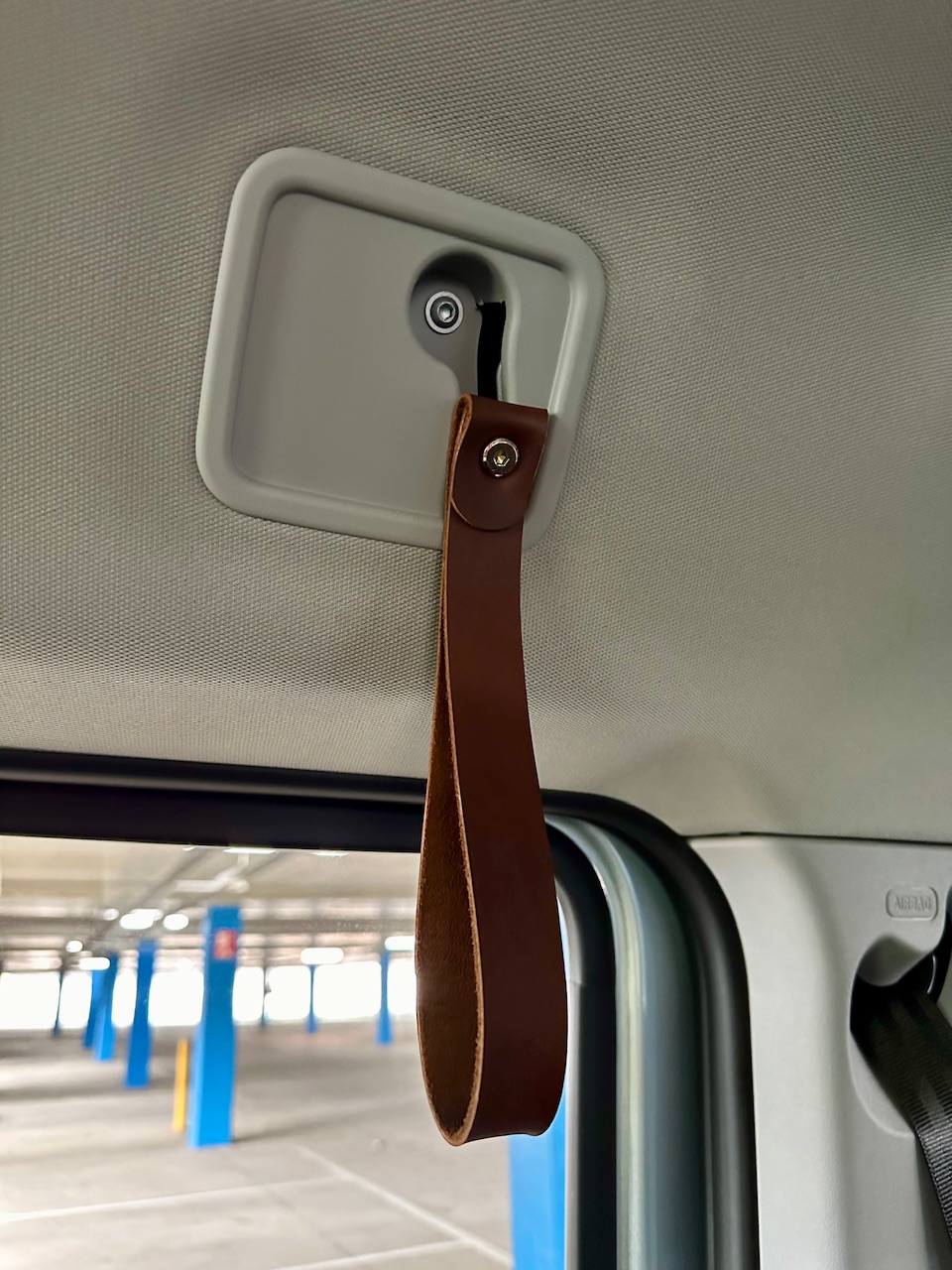

Finished my grab handles, cognac brown 20cm length from MyHide on Etsy. The length is spot on, will take internal picture later as too dark in garage. Leather has a bit of flex but still feels strong enough, will see how it ages.

Those look great. My son just got printer and did some for me. Gotta track down an old belt now

Those look great - and cognac matches the saddle leather well (good enough for government work)?

Here is the mounted handle.

Those look great and seems to be what my parents need for support getting in to the Grenadier.
How did you attach the strap to the mounting plug? Does it feel strong enough for someone to apply weight too or does that depend on the nut and bolt you use?

I used flat head recessed hex bolts, washers, and nylock nuts connected through 3D printed plugs.
