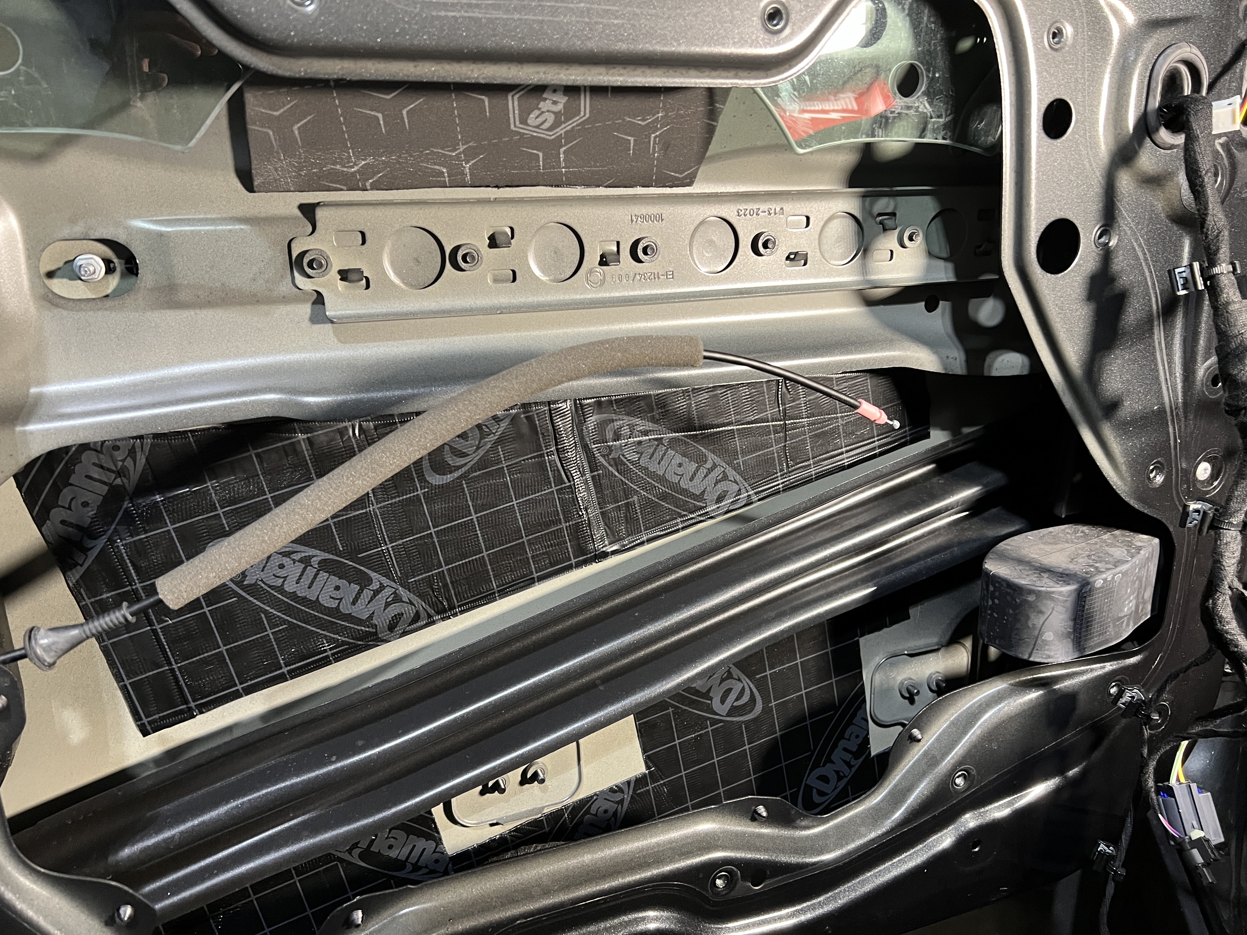

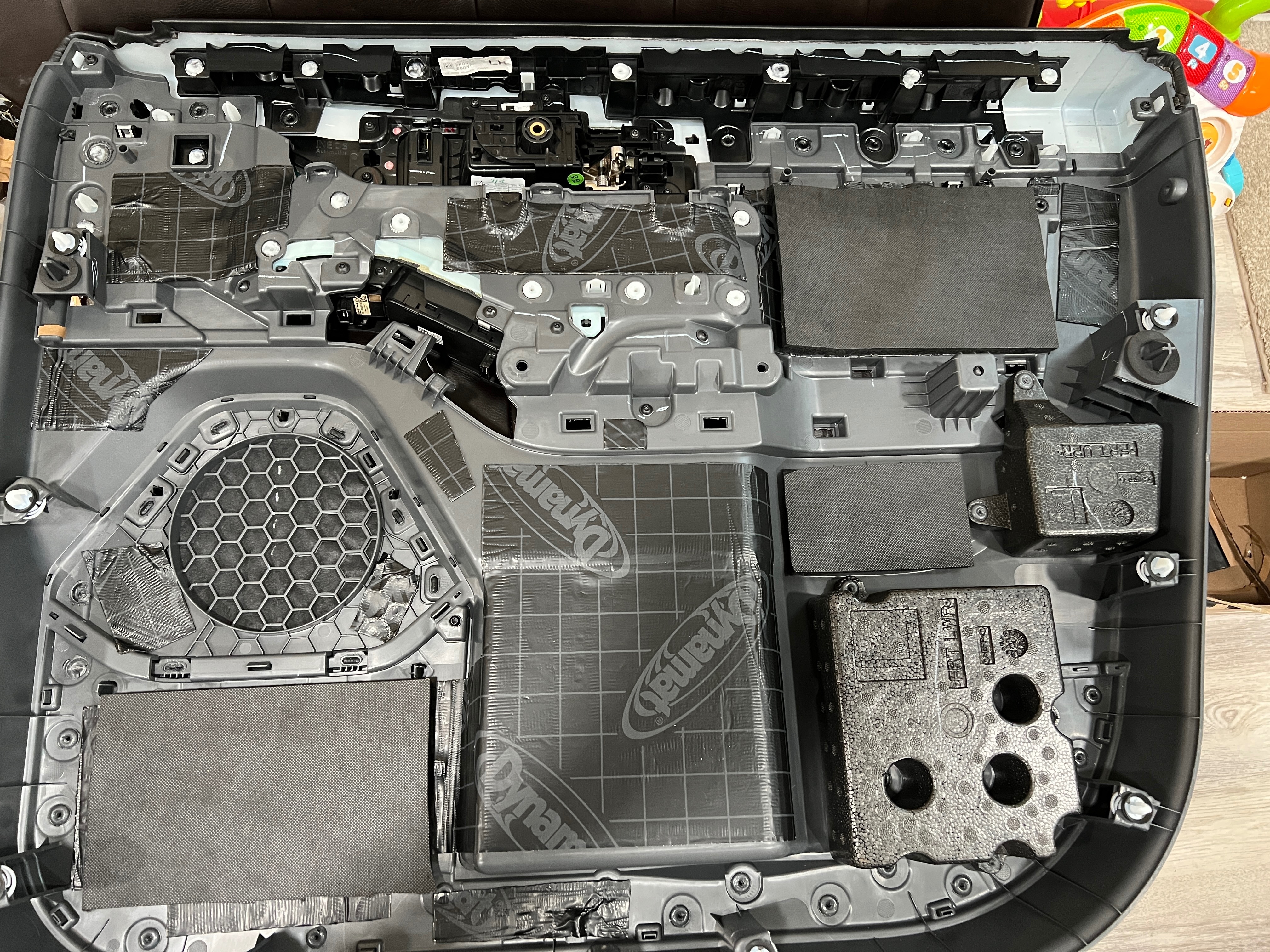

Do it yourself IF you have a lot of free time. I am not a big DIYer and so far I am half way through it. I've done all four doors, and I have to say the sound proofing makes a huge difference. I still have to install the amp, sub, a-pillars and wire everything up. I anticipate this would be much easier than the doors. The first door took a while but each door after that was quicker. With the amount of clips I broke on each door I highly doubt a shop would have replaced them correctly. I pre-ordered door clips from my dealer but those were not enough so I had to jerry rig trim clips into door clips. Another huge bonus is that you can completely sound proof the floors while you are doing the install.

I will tell you how long it took me so far, but keep in mind that i am also a bit OCD with cutting and installing sound proofing. Looking back i wish i just slapped everything on and stopped worrying about it.
First door: 4 hrs
Second door: 3 hrs
Last two doors: 2.5 hrs each
Estimate for installing the rest which i haven’t done yet:
A-pillars: 1 hr
Amp/dsp: 0.5 hrs
Sub: 0.5 hrs
Wiring (removing trim): 3 hrs
While doing the doors, i definitely wish i did not start the project. But looking back - i am glad i did because i learned how doors work lol.

The system came with an installation guide that details which material to use on different parts of the door. Before you start a sound proofing project I would get familiar with different materials and their uses. The resonix website has been a useful guide for me in the past, you don't have to buy from them - it just gives a general idea.
