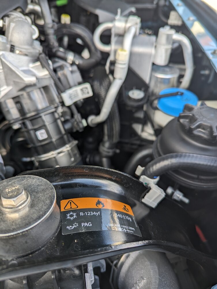

That's a good question. We get R1234yf.
I think I read that aircon workshops had to buy new evac and charging equipment to handle this gas. I'm unaware of physical differences with the connections though. Someone here will know that.

I'm not sure whether that's a change from what Ineos have said previously:
From this thread:
Post in thread 'Oil check' https://www.theineosforum.com/threads/oil-check.12348721/post-1333192154
Is that photo of an M1 or N1 type?
That's my Australian spec 5 seat station wagon so M1. According to the table above ROW was getting R134a but country specific. I'm not tracking the status of R134a here but there is another round of changes to permitted refrigerants coming next July so maybe Ineos has got ahead of that.
Yes the charging ports and test fittings between R134a and R123yf are different and can not be interchanged. Can buy top up cans of R1234yf from Supercheap around $200 AUD. Added an information sheet for Australia.
