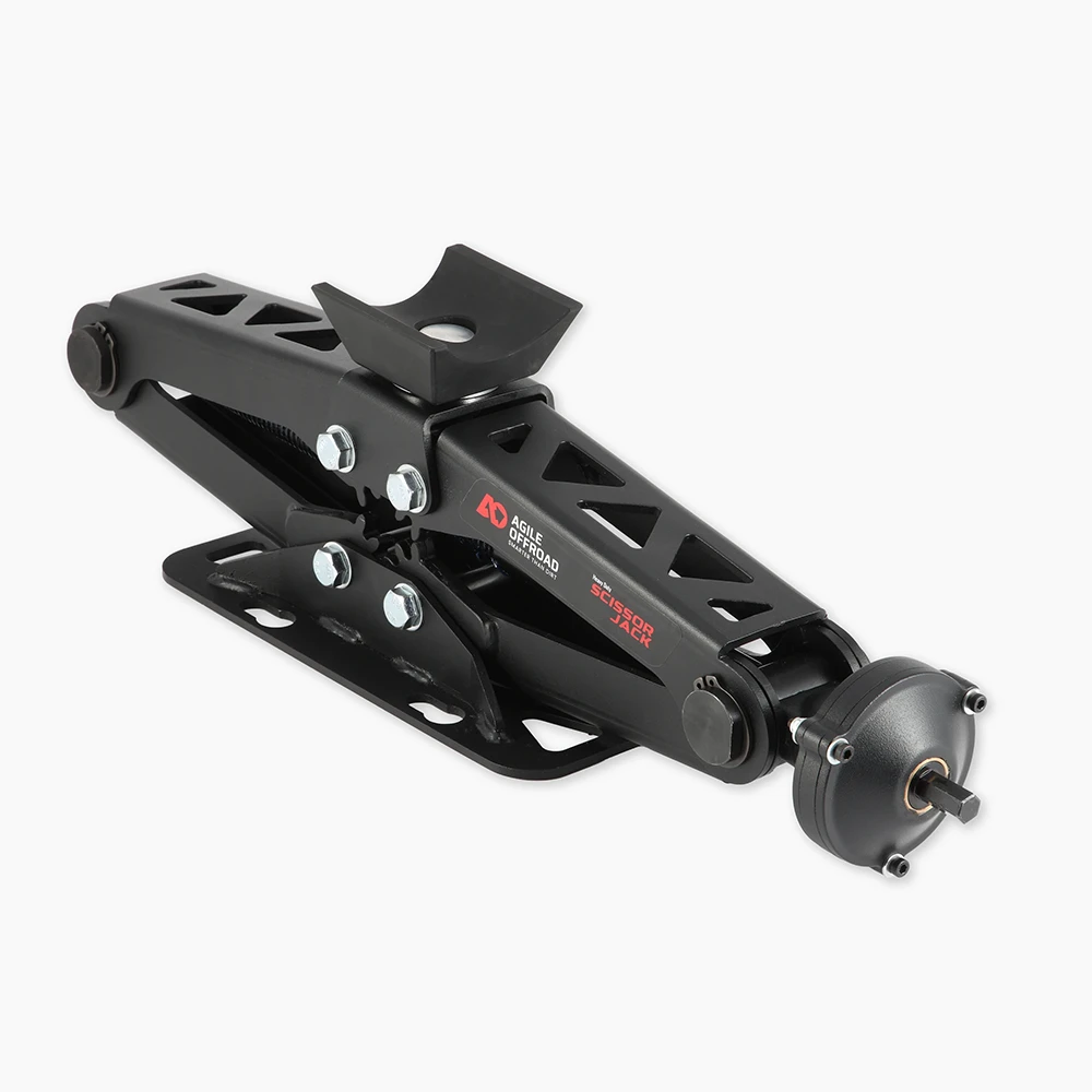

Which jack would you prefer for on and offroad use and why. Many thanks in advance.

I ended up buying the agile offroad jack. I got a nice discount code from agile at the moab event and that pushed me over the edge.
I'm probably still going to keep my hi-lift jack but i really prefer a traditional scissor style jack to an offroad jack if i'm just changing a tire.
