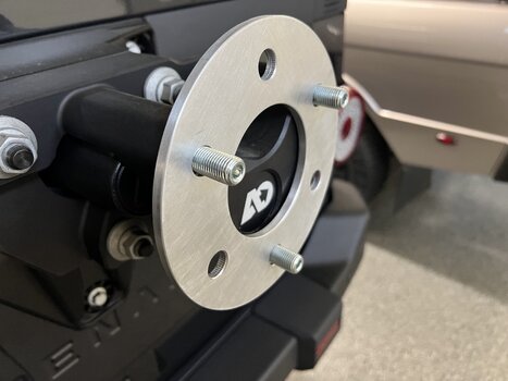

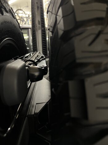

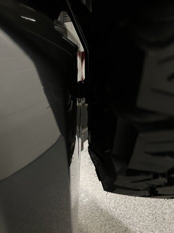

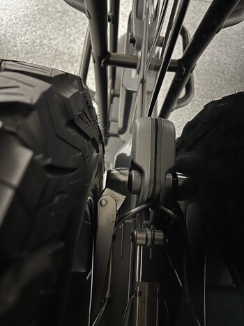

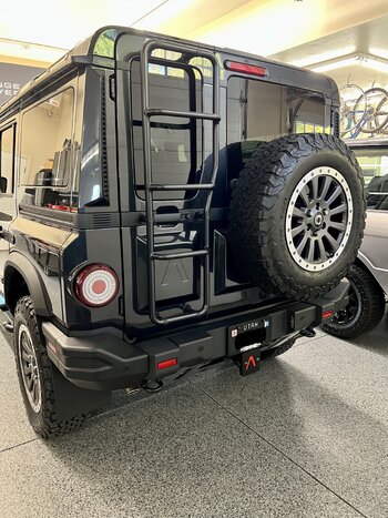

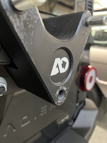

I’m using Agile’s reverse mount bracket on my spare 18” alloy wheel and even with the stock tire size it’s close to the wiper arm but still clears... barely! For added clearance I installed their spacer plate just to be safe. The more positive offset of the 18” alloys puts it really close to the door as the mount was really designed more for aftermarket wheels with less positive offsets.
If I end up keeping these wheels and mount larger tires I’ll most likely remove the three studs from the bracket and install longer ones and fabricate a thicker spacer plate to move the wheel out away from the door more. The view out the back is restrictive enough so not having a functional rear wiper, even for the little good that it does, wasn’t an option for me.
Your tire looks to have quite a bit more clearance than mine. It also looks to be a 255/70/18 and not a 285/70/18 that I've got mounted.

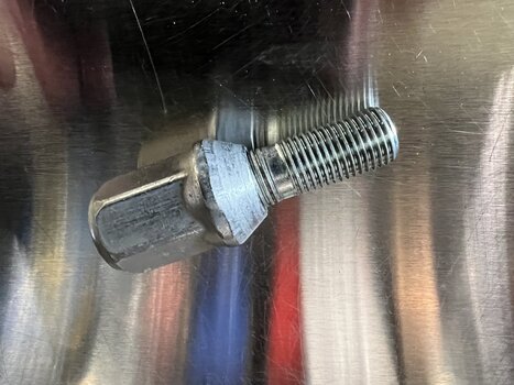

Correct, I currently still have the stock size but considering upgrading to the same 285’s size you are using on the same factory 18” alloy. So to make that work, as I mentioned, you can replace the three studs you bolt the wheel to on the bracket with longer ones. This would allow you to use a thicker spacer to effectively push the wheel out away from the door more restoring the clearance for the wiper. It really wouldn’t be that difficult to do assuming the studs come out easily. Just an idea for you to try and certainly the way I would go.
The bolts do not come out.

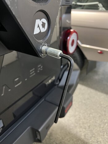

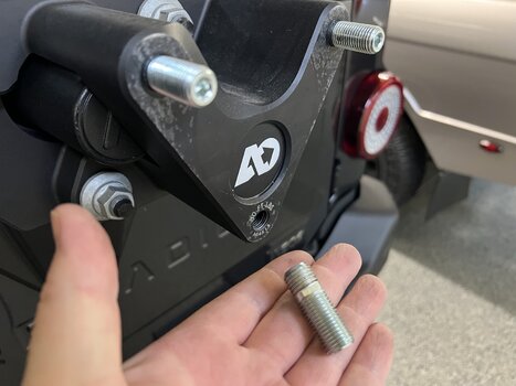

I wanted to verify I wasn’t leading anyone astray but you can indeed remove the studs. It takes a 7/32 Allen key and they are not in that tight fortunately. The Agile studs are approx 38mm long so if you can find studs that are say 10 to 15mm longer and are M14x1.5 on both ends that would be ideal. If you can find a spacer that is 10 to 15mm thick in the 6x130 bolt pattern then you’d have your wiper/door clearance back.
Make sure whatever length studs you use the spacer is the same thickness (10mm longer studs use a 10mm thick spacer). Hope this information helps as it’ll certainly let me go with the same size tires you have which I really like.

Also, posting this about three of your posts ago would have sufficed. Why wouldn't you have put this out there previously to help people out? Is there some big secret?
I actually haven’t done this modification yet because I haven’t moved to larger tires like you have. Your issue with the spare tire clearance simply got me thinking on ways to address it for folks with the Agile bracket and for when I move to larger tires. So today I went out and simply verified the studs are removable (which I just shared above) so we weren’t chasing a red herring.
The spacer in the images I sent is just the Agile spacer they offer which I order at the time I purchased the bracket as I wanted to be prepared in case the stock wheel didn’t fit if that is misleading? And just to be clear on a stock tire size the 18” will clear the wiper without the spacer.
So that picture is of the original studs and spacer? Not anything you've found to replace them?
Correct, sorry if that was a bit misleading but I had ordered the spacer with the bracket because I had a hunch the 18” wheel offset might be tight and I may have needed it. I still used the spacer just to give the extra clearance to avoid bumping the tire on the door when you lift it on and off.
I see. You got those pictures so quickly, I assumed you had already done of all of this.
I wish I was that fast… it was more of a thinking exercise and verification that doing a small mod like this would work for us and the key was getting the original studs out which is a non-issue.
You could take one stud out and go to a local Fastnel or Grainger (nut/bolt) store in your area and see if they have anything in stock that is longer. If not, they can take measurements of the stud and order what you need as it’s important the length of the stud which screws into the bracket remains the same length. The added length you need will be on the other end of the stud if that makes sense?
As far as the spacer is concerned the Agile one is about 6mm thick so in theory you could double those up to achieve 12mm which might be enough to give you the clearance you need. Where this is not an actual rotating wheel and just a spare tire mount I don’t think you have to get fancy with expensive hub-centric wheel spacers or anything like that. If all else fails, you cold buy the Agile spacer and take it to local machine shop and have them make a copy of it but the thickness you need.
