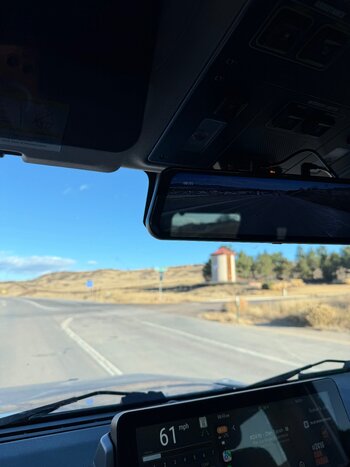

Just installed the g900 tripro.
I am extremely underwhelmed by the rear camera.
In broad day light, the rear image is significantly darker than the front camera. It’s dark enough to make it a safety issue. On a sunny day, the view out the windshield overpowers the dark image from the wolfbox’s rear camera
It doesn’t help that Wolfbox doesn’t allow you to adjust expose compensation for the rear camera.
I am surprised by the lack of more people calling this out. I would not have gotten it, if I had known about this tremendous drop in usability with the rear camera. Makes me wonder - Something wrong with the unit I have?
@WolfBox will you guys be allowing exposure comp on the rear camera? Doesn’t make sense for that feature to be limited to the front camera

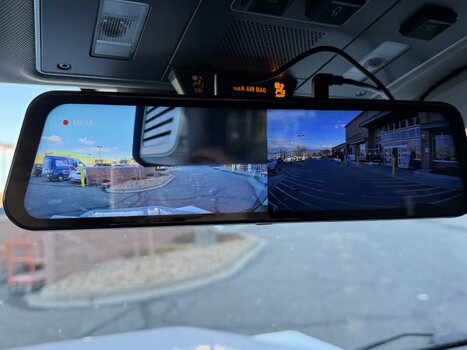

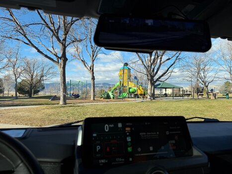

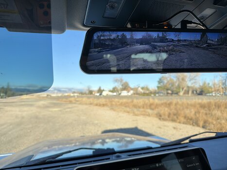

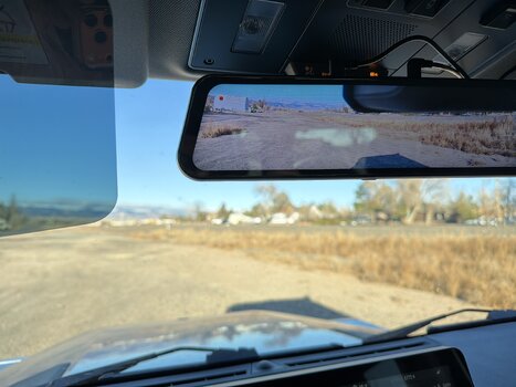

Photos below taken in manual camera mode. So there is no auto exp compensation from my camera.
See the image of the wolfbox comparing against the infotainment screen, to give you a reference.
A photo of the front camera is also attached to showcase it’s not a display issue. Purely a camera issue
