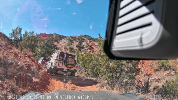

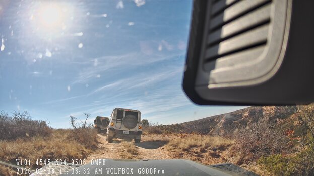

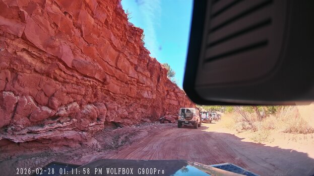

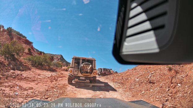

Can we put an offset in it to get a better field of view for the dash cam?
The ADAS creates a HUGE useless spot in the front Wolfbox camera. Any improvement ideas would be appreciated.
Do you have a few photos showing what it looks like with the mounting bracket? I’ve never tried it on a Grenadier with the ADAS system before. Sorry for that;(
As a matter of fact, just came back from a Grenadier event at Merus Adventure Park in the Palo Duro Canyon in the Texas panhandle. EXCELLENT overlanding. Got some good images and videos but here is what I capture off the front camera. I usually try to crop out the ADAS from anything I want to show people. I may in the future mount a go pro on the rack to capture excursions or mount to the windshield from the inside to avoid dust and noise.
