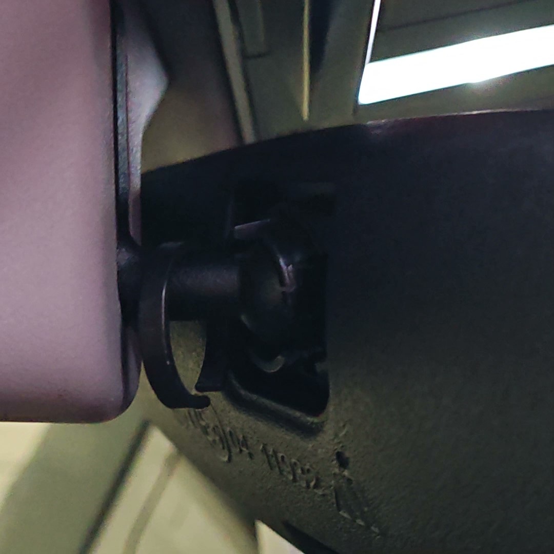

Does anyone know what the best way to remove the stock mirror from the ball joint. Is there a tool or a release clip. I have the wolf box adaptor to use the current US spec mount but I don’t want to damage the old mirror in case I need to use it again.
It is in this thread somewhere. Need a screwdriver to pry the black metal ring away.
small flat edge should easily 'pry' the ring enough that it pops off.
