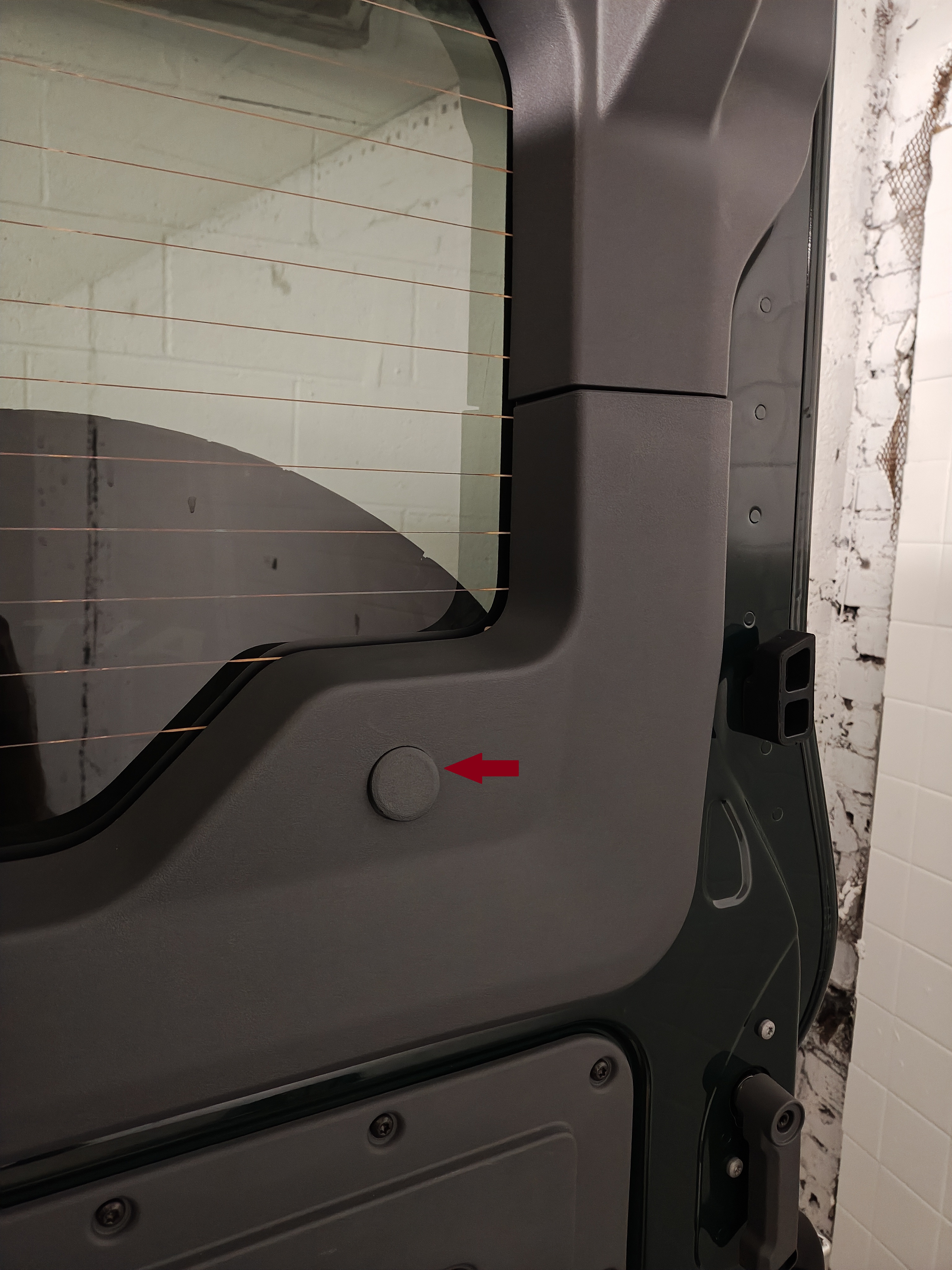

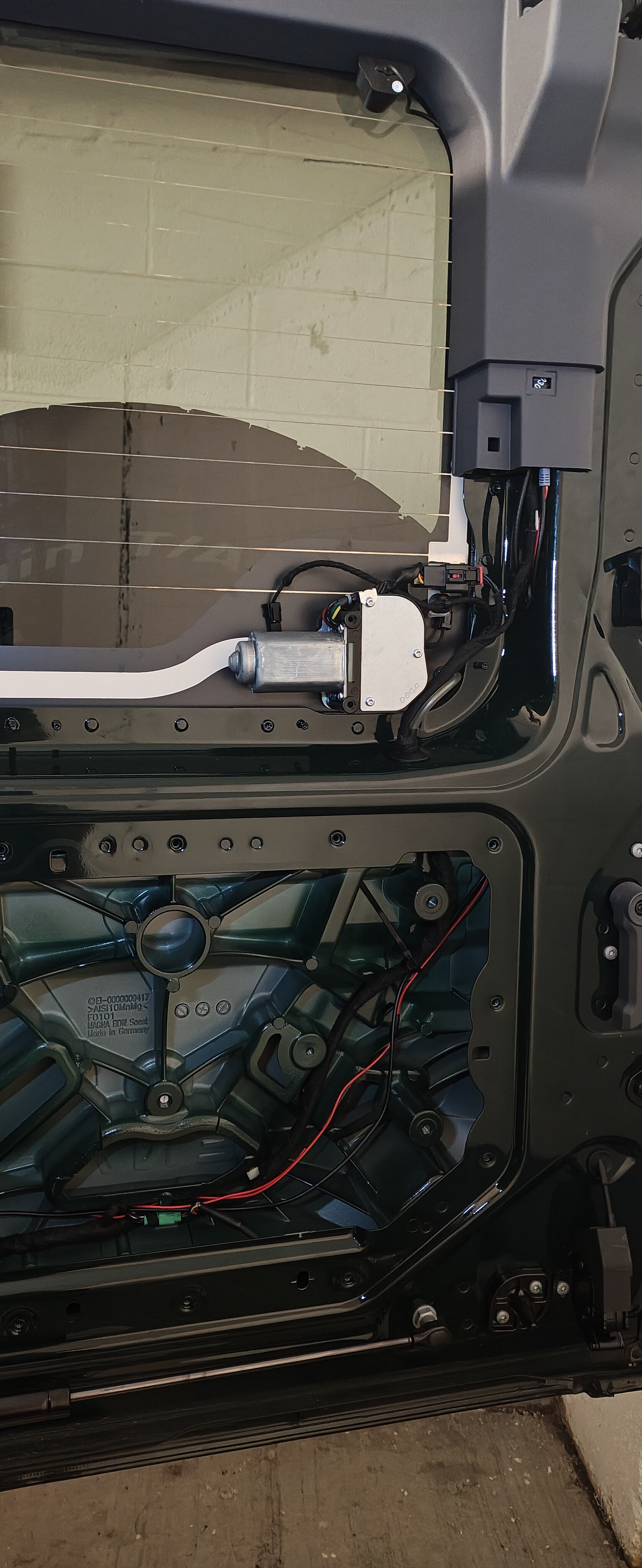

I moved my interest to the rear. Here I chose to mount the "HD" camera inside along the top. This was probably the easiest part of the entire process.
I removed the plastic cover and using the torx bit, remove the screw. I was then able to unfasten the rear plastic by using the nylon flat trim tool and inserting along the OUTER edge. Avoid using thing hard against the glass side, as the Rear Defroster wiring is here.
Using the flat tool under the outer edge of the trim, twist then pry and the plastic should give a resounding "pop". A firm yank should set it free.
With the bottom part removed, repeat the same for the upper, "using the nylon flat trim tool and inserting along the OUTER edge." This should give you all the room needed to run the wire from the camera down along the inside of the upper trim. Remove the torx from the rear storage box gives you access to the lower door section.

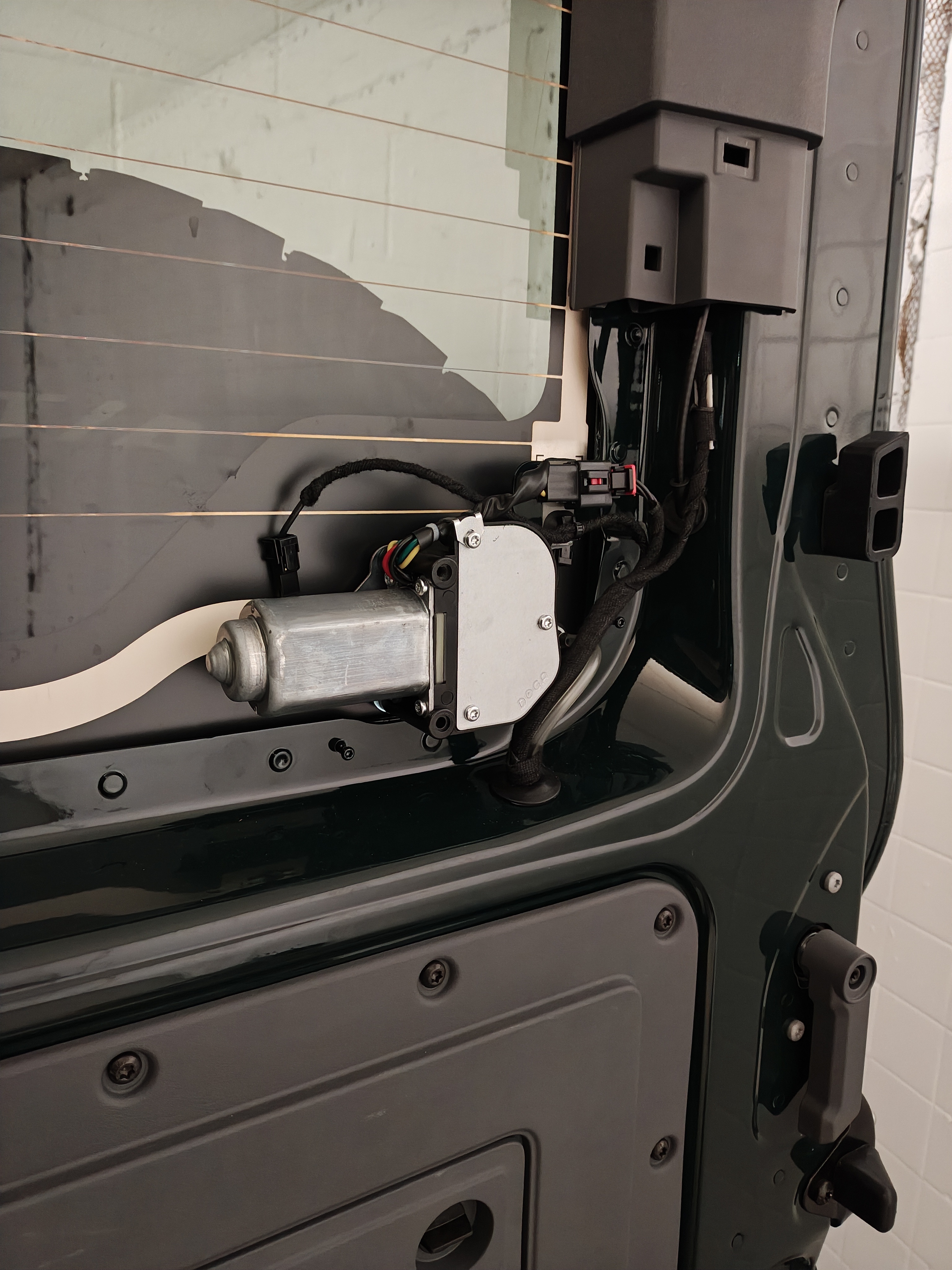

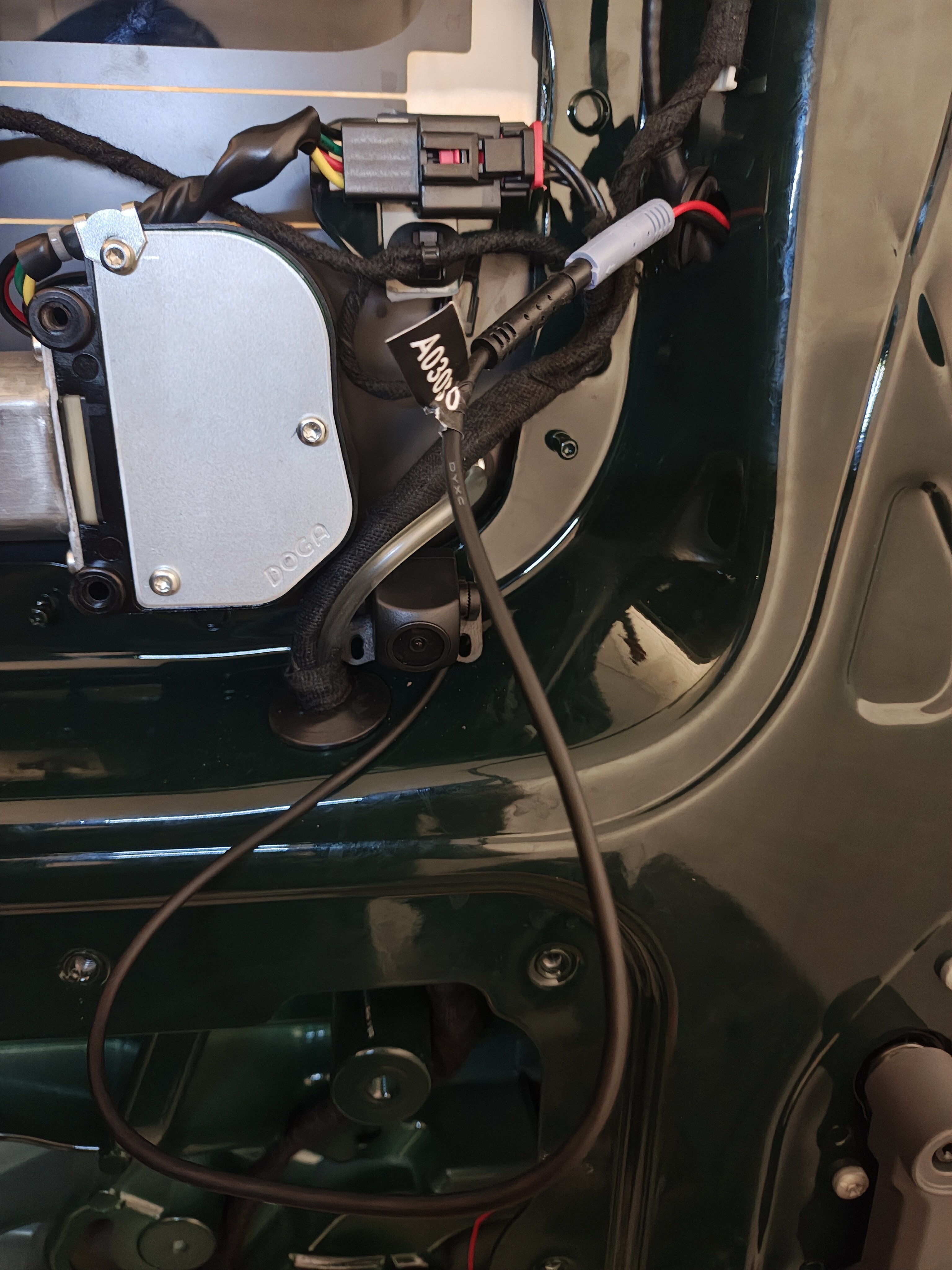

We can see here where the OEM Wiring harness comes in. The wires going "down" are to the built in rear camera (which suspiciously feels almost exactly the same as other rear camera plugs) then run a bit more and then UP. Here one set runs toward the rear wiper/washer. The other runs up to the rear door lock.View attachment 7865109
--And Here the AV wire from the cabin, enters the rear door using the hole provided. The wires then drop down and run along the bottom interior of the door.
With the wiring feed into the rear door, I needed a way to run up where the camera connection is. To accomplish this, I lifted the sealed grommet for the power lock use the camera and then dropped the camera "tail" down, to where I could connect the AV wire.
Then pulled the cord up with the AV wire attached.
***IDEA : identify the signal wire for the read wiper, as it turns on automatically when you put in Reverse., would be easy way to get reverse functionality. Unsure if better done at washer/motor, or at loom (where built in reverse).
Once connected, I carefully pulled the AV wire up through the door, slipped passed the grommet (resealed with a bit of lube and persistence).
Here is a shot of the camera installed and the wiring feed through the rear door, then up to the camera.

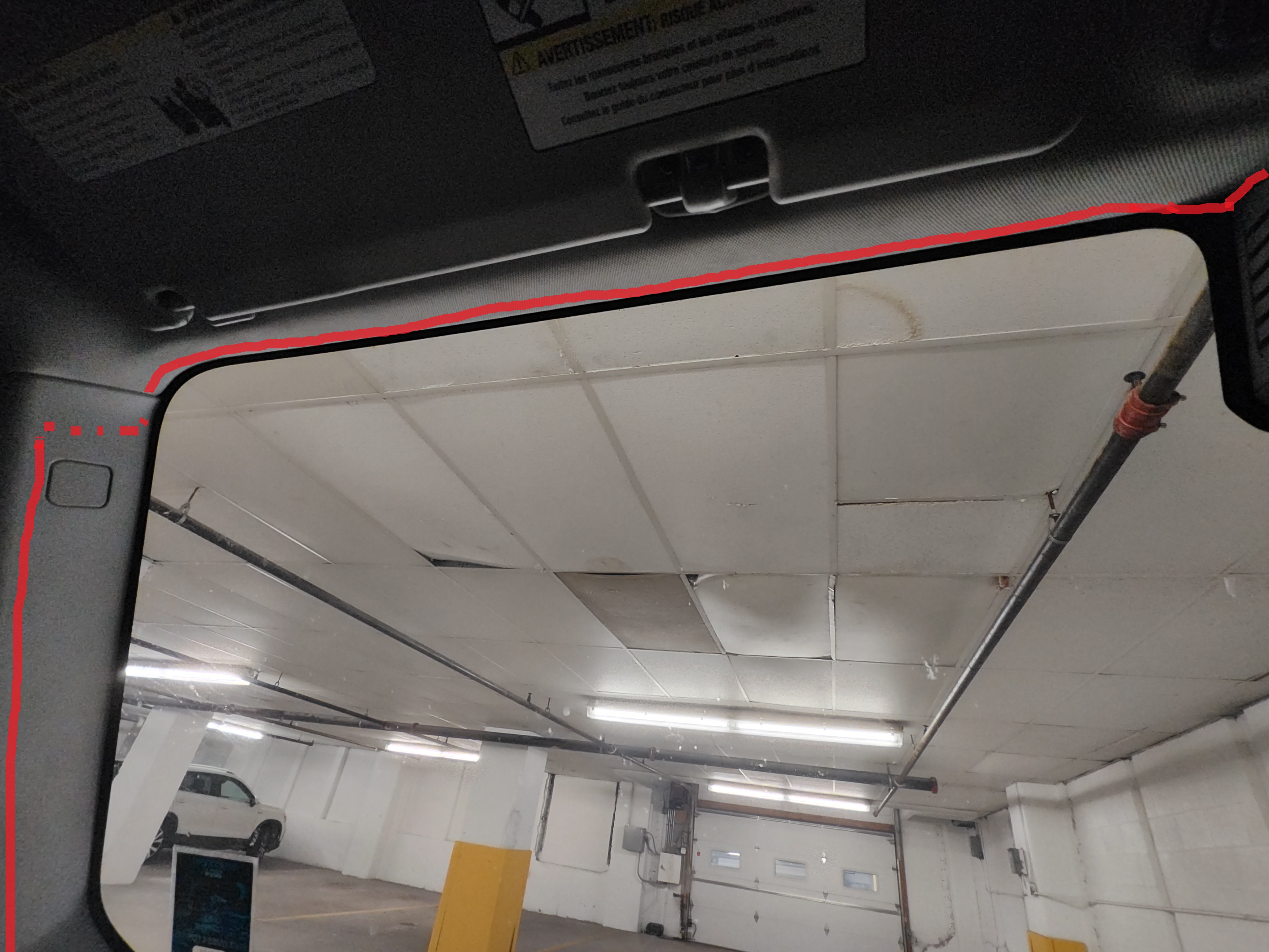

I just installed a G930, for the rear camera I went through the top edge of the headrests along the door panels and weather stripping on the jams. I then went under a trim piece which has to get unscrewed and to the roof without making any holes. Figure I'd share since we all basically have the same make and model lol. I used the double sided tape to hold it down but I was worried that it would fly off in a car wash. For some odd reason this part popped up on amazon for a corvette

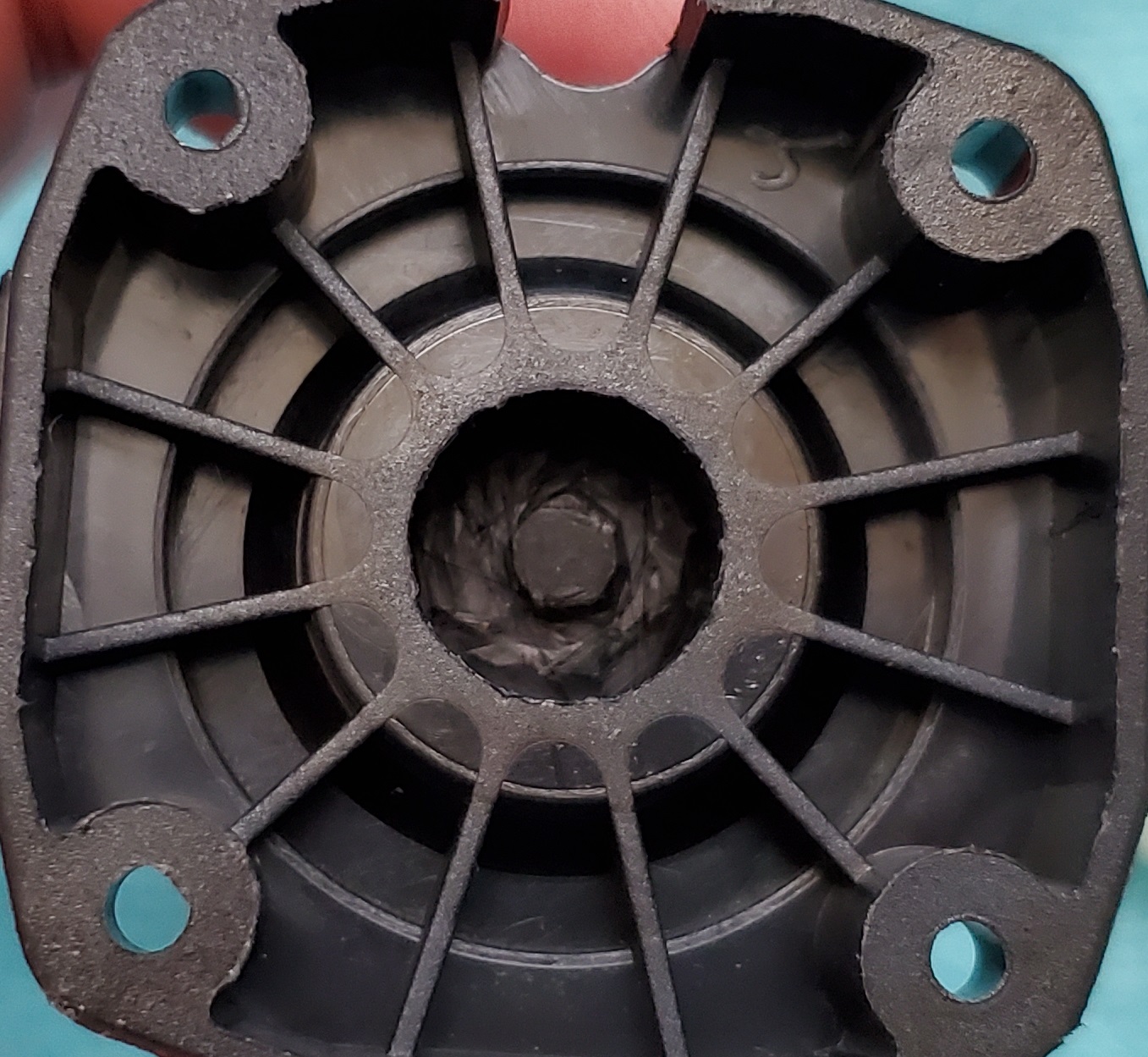

Preparation of new mount/adapter:

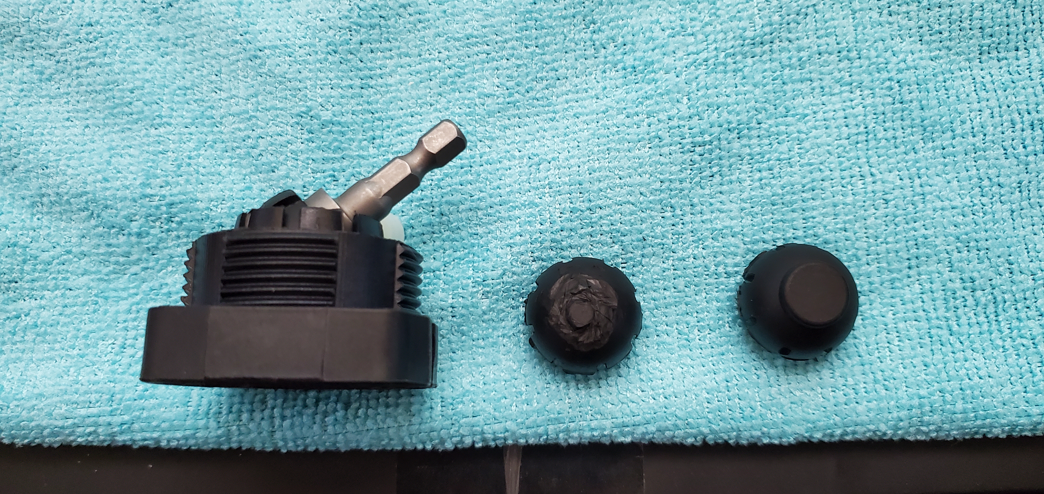

The provided "adapter ball" joints allow the use of a 22mm mount of Wolfbox Bracket on the 15mm ball. If left unchanged, there is very little "adjustment" once installed as it is limited by the large "nub" (raised end) that fits into the hole.
If we compare to the OEM, the difference is quite noticeable.
Here are comparisons of each, nub removed completely, nub trimmed down to closely match OEM and the as delivered.
--Results:
--Out of Box
--Closely matching OEM
View attachment 7867328--Removed
View attachment 7867329--OEM Enough
I choose to stick with the little nubling (OEM-ish):

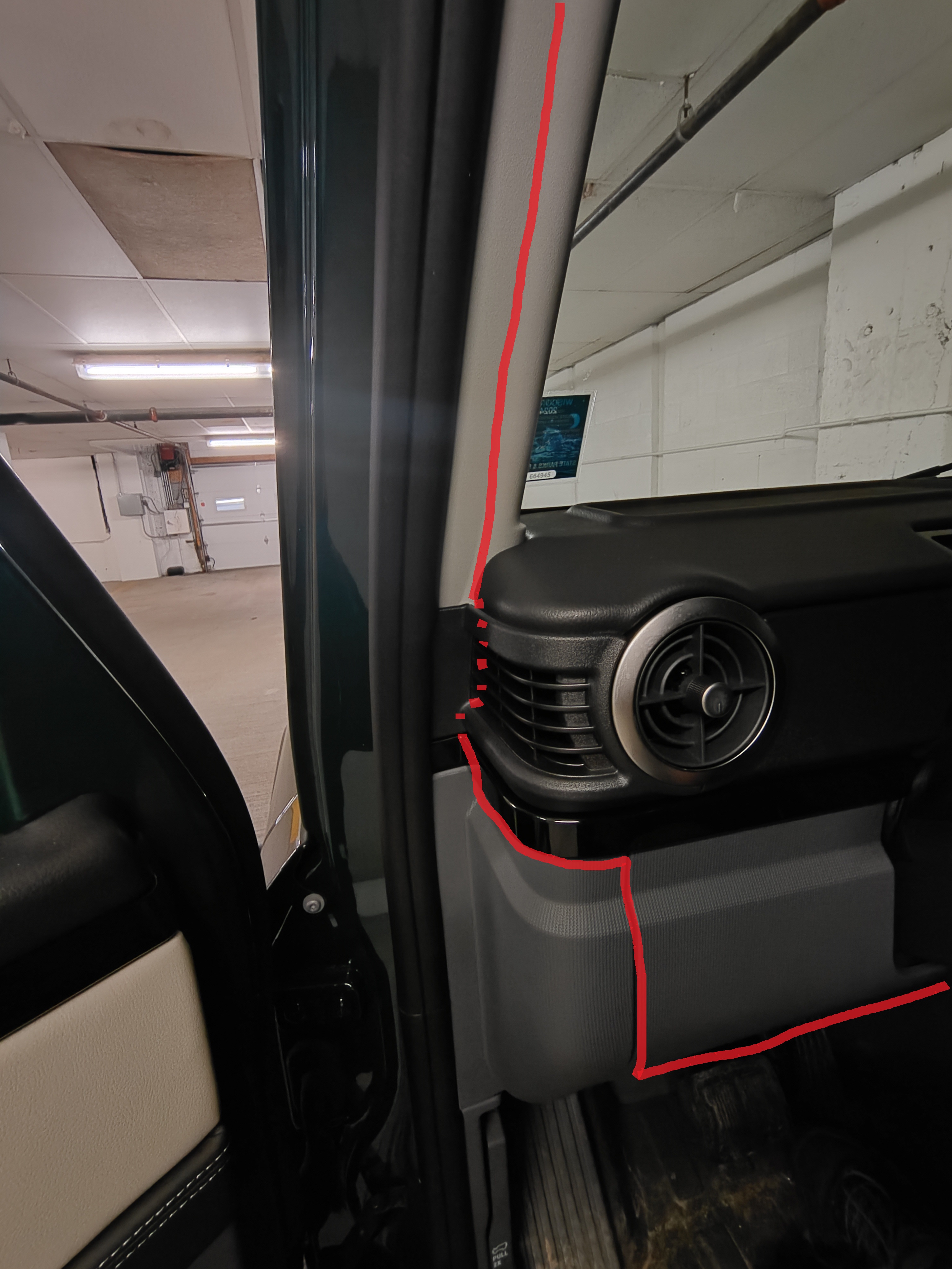

You may or may not be able to make out in the photos, the wiring for USB(RED)/AV(BLUE)/GPS(GREEN) are "tucked" up along the headliner. The USB uses the 12V connector (RED) that I ran along the top, to the driver side (NA spec) to the A- Pillar , pushed the wire into the headliner.
View attachment 7865359Here I removed the Driver side A pillar cover. It is a small (T20?) torx behind the small plastic "cap" (DO NOT LOSE!!, Those "little" bits are notoriously expensive ($90USD +) )--<add pictures of A Pillar here>
I ran the 12V/USB down, along the outside, so not as to interfere with Airbag deployment. Here a little bit of wiring is exposed, however I was able to use some nylon (plastic) trim tools to help push the wire in and behind the trim.
I ran this horizontally along the driver footwell, then under the plastic, then "popping out" just before the center console.

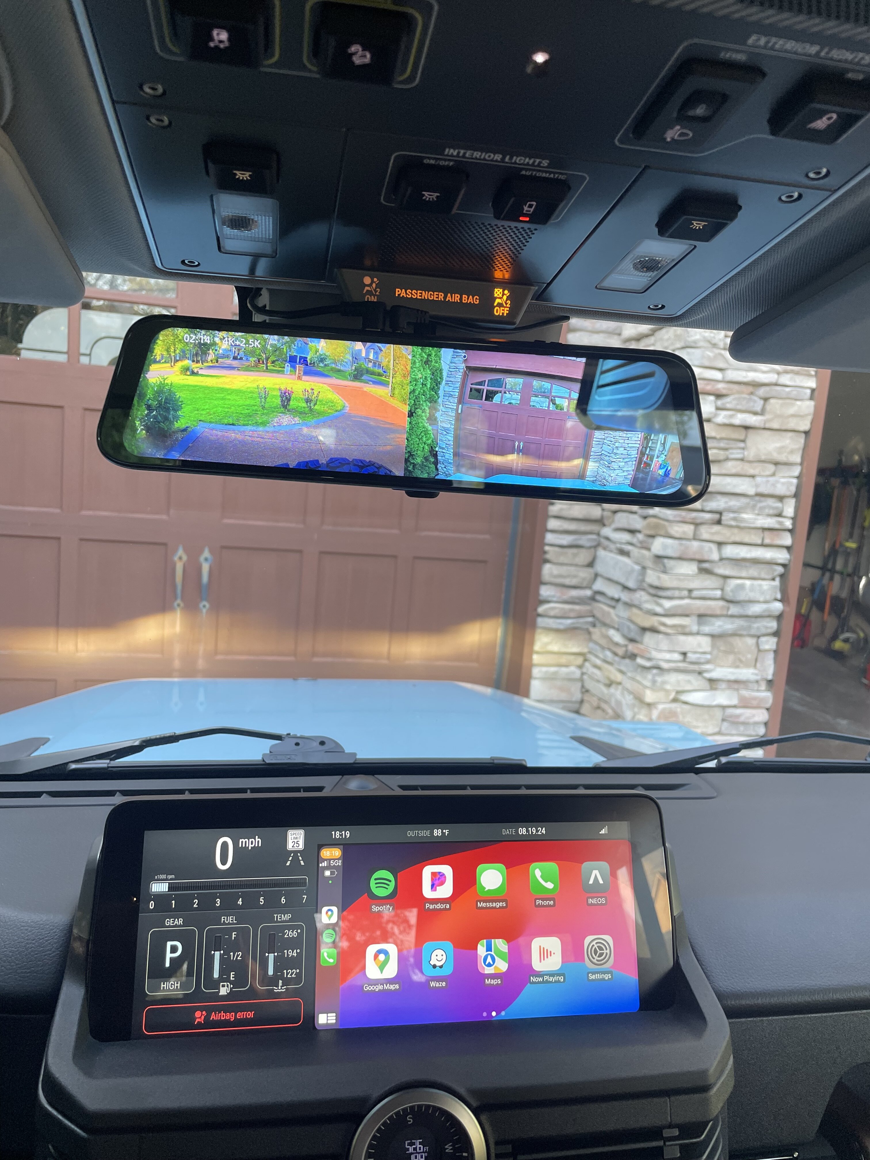

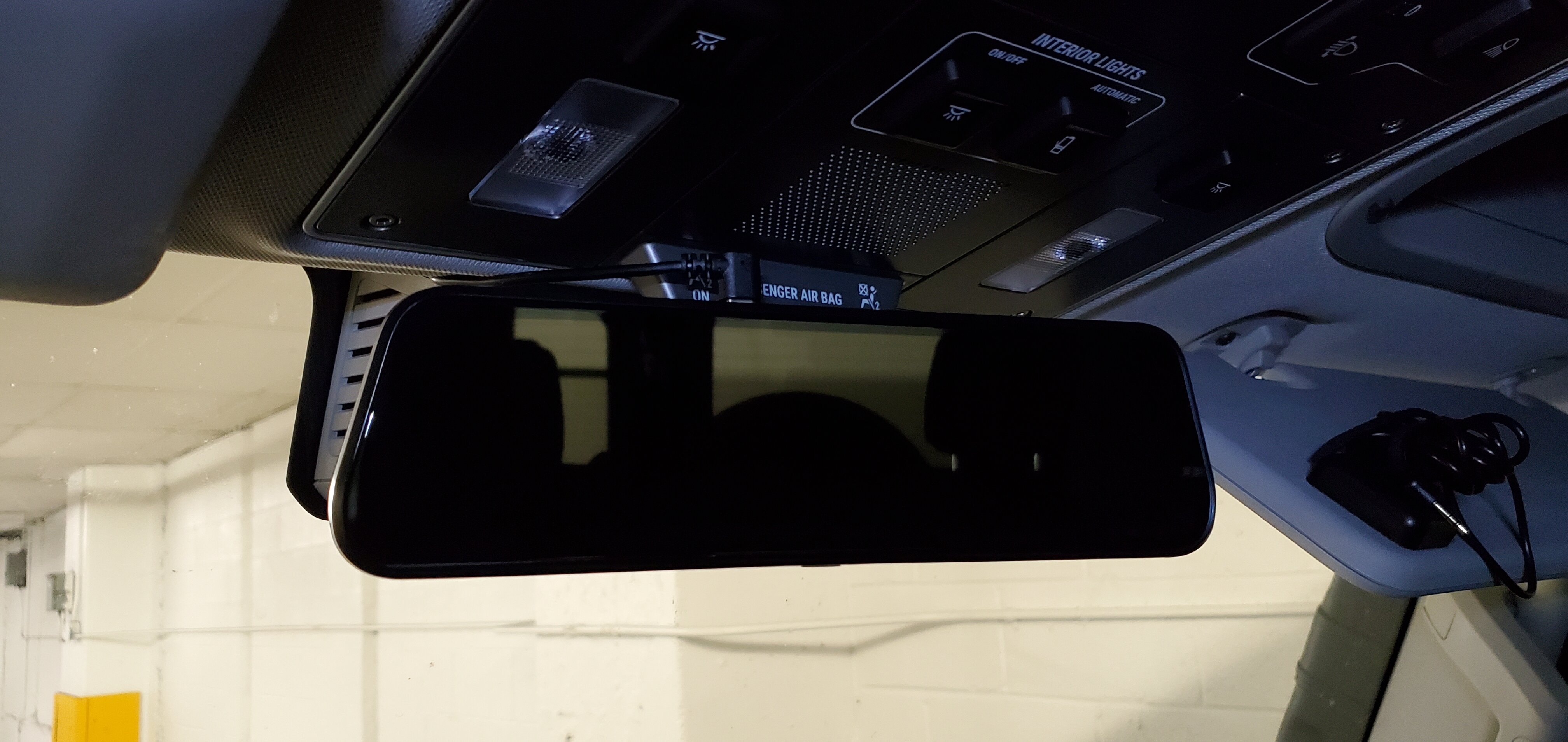

Here is the Wolfbox installed with the OEM enough mount (will get better pictures later)

The ADAS box does block a little and I have my mirror mounted as high and to the left as possible. I usually leave mine mirror showing both front and rear cameras. With the size of the mirror, I do not find that the ADAS box is that bad.
BTW, pay no attention to the exclamation point on the left side. That is actually duct tape showing the center line of my garage bay for something else. lol
