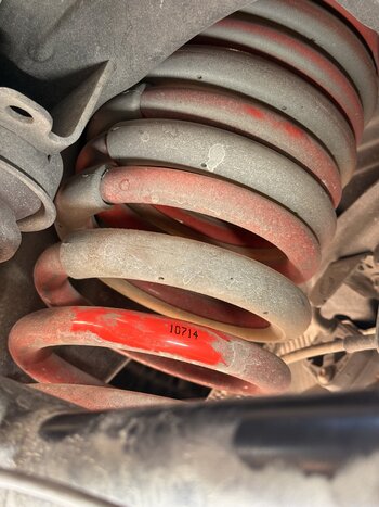

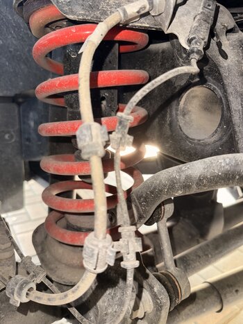

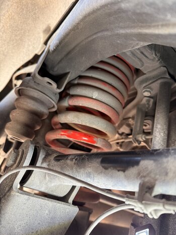

I bought a second hand Grenadier back in May and have done about 20k km in it. Most weekends have been spent in the dunes of the Middle East (when it hasn’t been too hot).
Before I made any upgrades, I wanted to see how the vehicle ran “stock” but now I’ve started poking around. It seems that some upgrades were made to this vehicle before I took ownership. Some I already knew about - air-lines going to each of the four wheels for example - but others seem less overt.
Take a look at these pictures, does anyone know if this is stock suspension or an upgrade to the GVM? I don’t believe that there has been a lift, but I might be wrong.

I've only ever seen yellow factory springs so I doubt these are the originals The wire size looks a bit thicker than standard so they might be heavy duty. I don't recognise the red paint.
I'm not aware of any HD springs that are not a lift spring as well. There is growing interest in that option. I'd also be keen to learn what you have here.

I saw those also. I've only ever seen Dobinson springs in their signature teal blue colour. That might not be reliable though. These springs have part numbers visible so it's the original red paint or powder coat. I found some Eibachs with PN 10713 and 10714 but they're black and for an Audi A6 so probably a PN coincidence. Maybe get a wet cloth in there and see if you can find any other markings?

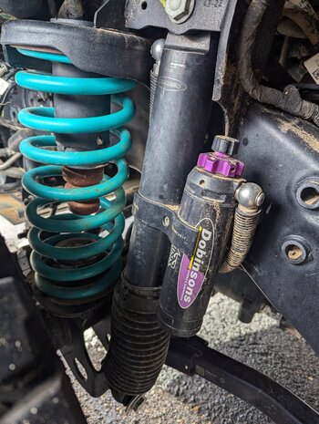

This pic is a Dobinsons lift kit on DMW's Grenadier.

There is a Dobinsons store in Ras Al Kor which is why I thought it was them over Tough Dog (only other red ones I can find). No indication in store website on colours but as per @LRNAD90 above, seems like they do come in all colours.

Aah, here's the same part number on the Dobinsons Australian website. A choice of Teal, Teal or Teal. A cross check of a couple of other popular makes is the same. It seems Dobinsons might only offer the teal colour in Australia. Weird.

Given my truck is second hand to me I can’t comment on the stock suspension. The Dobinsons I have aren’t impressive. Most of my off road is on drives and at pretty high speeds and they deal with the weight of the truck, the soft, shifting sand admirably. I think with some upgraded dampers this would be a fantastic set up.
